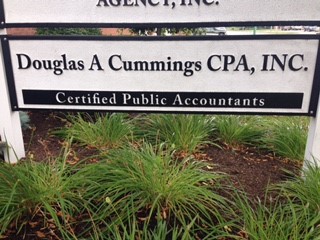

A customer has asked me for a quote to replace 1 section of an existing sign advertising 3 different businesses.
I need a source for inexpensive pre-fab letters so I can remake this sign.The new business does not want to invest in a complete remake since this is a temporary location. We will grind of the top row of lettering from the redwood and replace, the bottom text remains the same.

What size are we talking ??
Ain't no way he got that routed, painted and hung for $306.00, on redwood, unless it's 4" x 12".
Sorry, Since I was looking for stock lettering, I didn't think to mention the size. The sign is 18" high, 6 ft long, the capital "D" is 5" high.
There is no way you can make a sign with those dimensions for less than $300, even if you use the same piece over somehow.
Offer them cut vinyl on a piece of 1/4" alumalite for about $450 and if they don't laugh or kick you say plus installation.

Make a layout and pattern, buy some gatorboard and cut them out on a bandsaw or jigsaw, prime and paint them and glue them on the area you knocked down. That's about as cheap as you will get for a temporary sign.

grinding-down the existing name sounds like you're eating most of that in labor of install. i mean, Gemini makes great lettering BUT, as stated above, they are pretty pricey for a "temporary"sign.
....a 1/2" PVC "HotDog" with vinyl lettering mounted right over the top of the existing letters would keep you within your client's assumed price-point, with install included.
Just as easy, would be to simply take a black panel @ full-size, mask off your frame & lettering, then paint it with textured white. Screw it right over the top of the existing, and you're set until when/if the client decides to go for sandblasted redwood.

If you want "stock" letters, then start looking on craft sites and in craft stores. They sell crappy wood letters which you can paint with black spray paint. Assuming you do a better than decent job painting them, they should hold up for a few years maybe.
In the end, as others have suggested, the way you're going about this is just wrong. Knocking off the letters, sanding, painting, buying the letters, and mounting everything is likely one of the most expensive ways to handle this project. As Gino mentioned, simply putting up a vinyl sign mounted on whatever you have laying around is definitely going to be more cost effective. Hell, you could even put a banner over it if it's truly temporary.

anything dimensional is going to be pricey. can you order from Harbor Sales? You can have the letters cut out of PVC, and then finish as needed.
But honestly, if its just temporary, why use dimensional letters in the first place. I'm so confused.

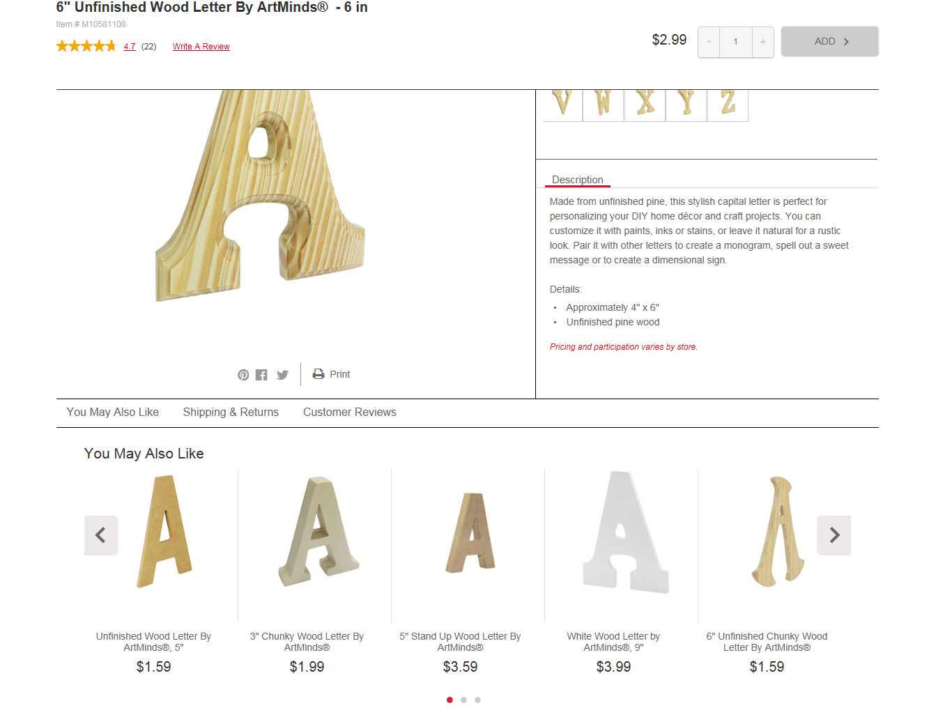

how cheap are you looking for? places like Michaels craft stores sell wood letters that might do the trick.
