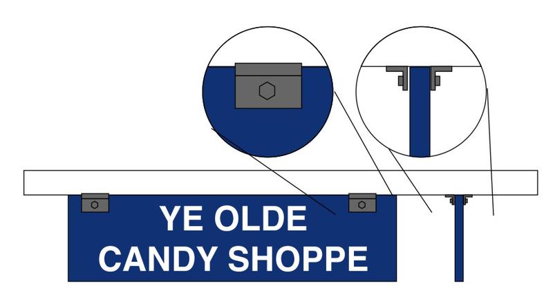

a bit exaggerated, and obviously paint to match, but this is an economical approach
thanks, i am hoping for something a little nicer, but you are right, this is an excellent economical sign. i'll give them this option along with hopefully something else.

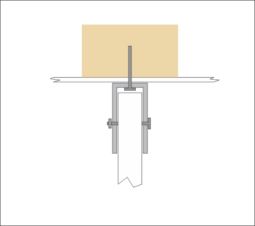

this is exactly why I asked for ideas. we can actually access the inside, there are no other signs because it was just redone and all the old ceiling mounted signs were removed, and there are cross supports that we plan to use when we install. we know what the framework looks like because its right outside our shop :smile: . My landlord is "thrifty" so I know if I need to propose something that he'll be able to swallow without lecturing me about how he just put a bazillion dollars into our storefront and bla bla bla. we are also insanely careful with all of our installs and will over-engineer things because we are so afraid of it falling down!
Anyway, I think we are going to get 1"x2"x0.125" aluminum U channel and install like this...
