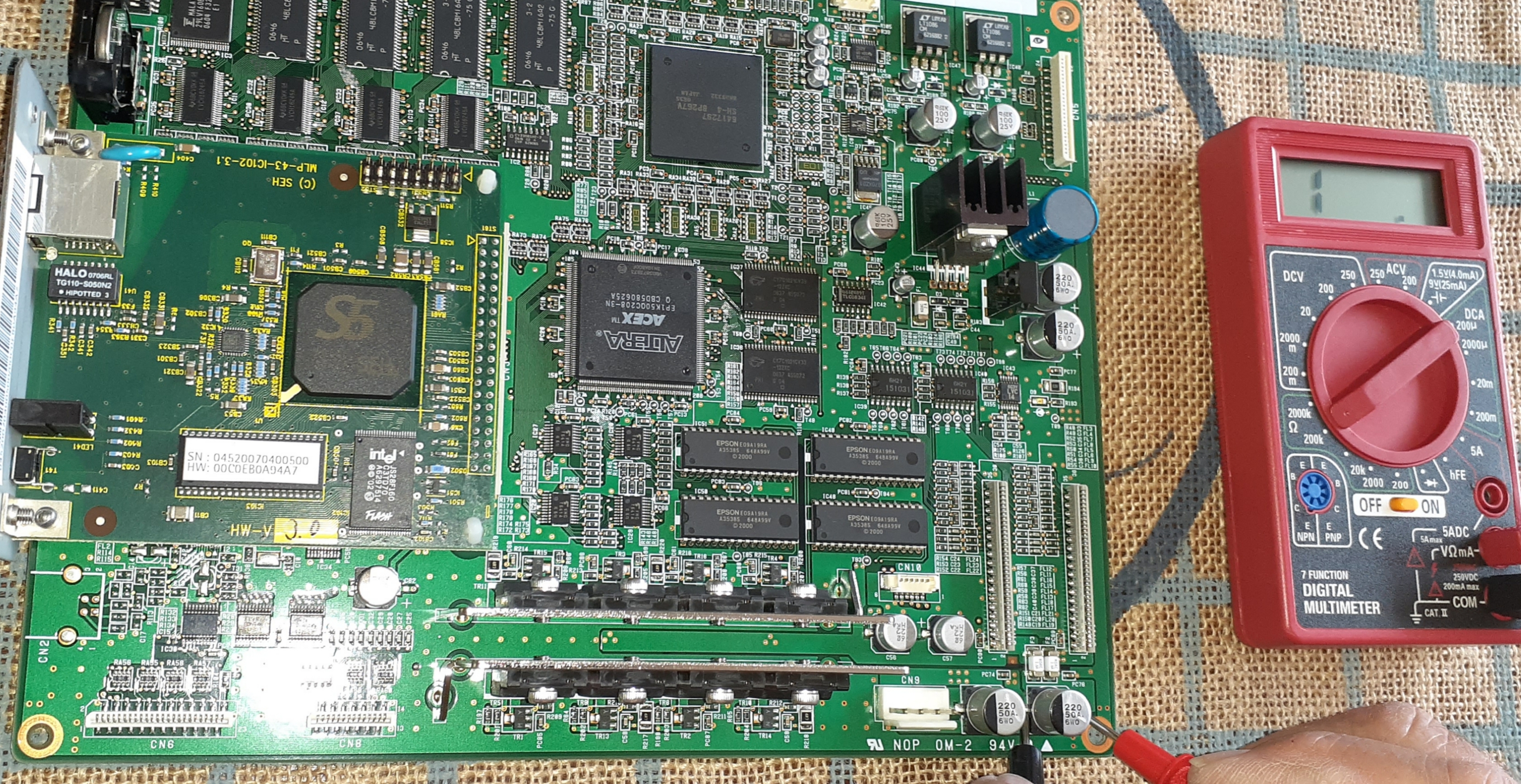

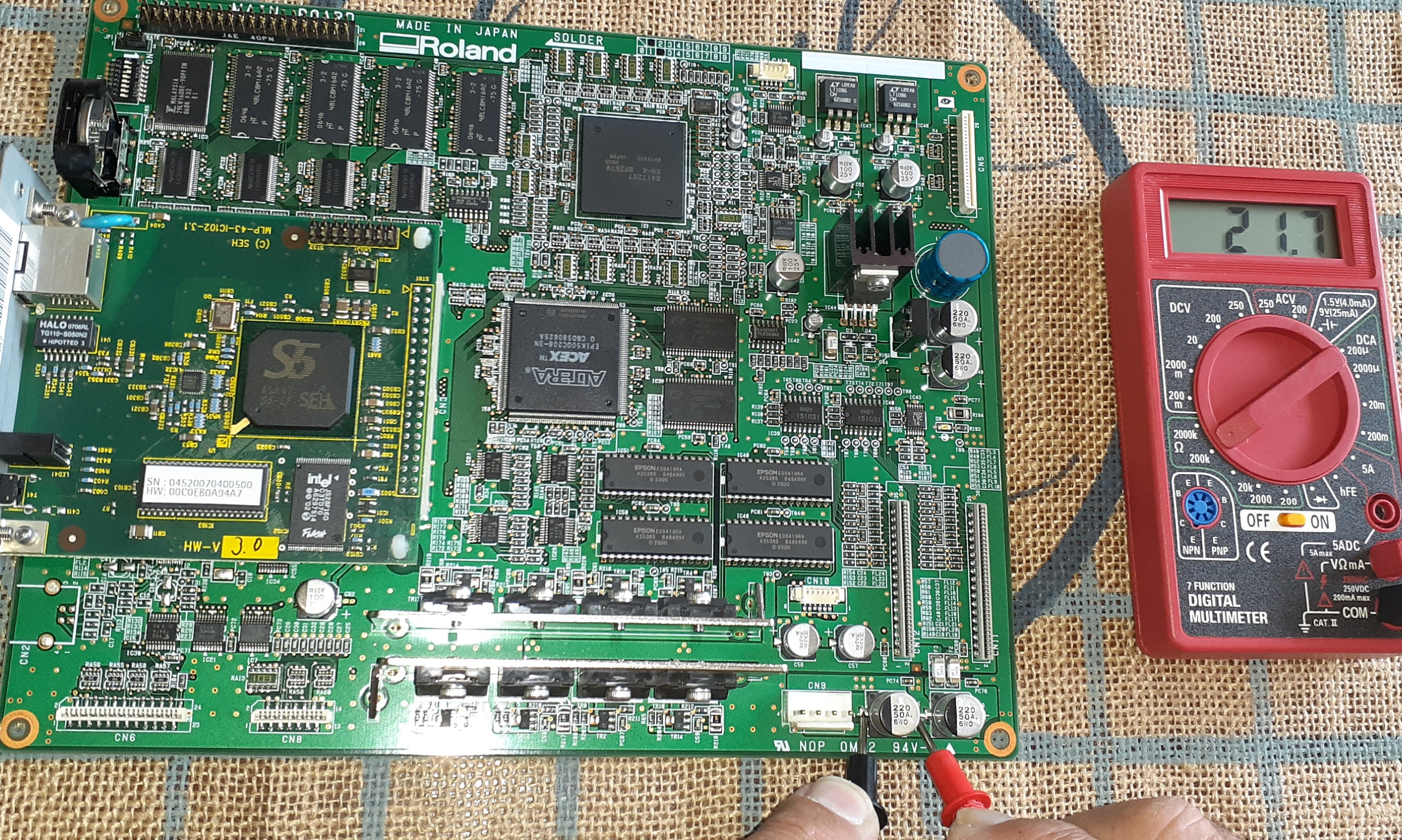

I removed the mainboard in case we have to do some more testing. I tested the two fuses. The inside gives the following reading...the outside appears to be dead

Those are capacitors. The fuses are in the red box. They should read 0 or very near 0. Will read open if blown.
