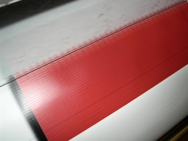

jiarby
I am still getting this... thought a bump might be in order.
New picture... to kill the plasticizer conspiract theorist. This is on 63" roll of Jetflex Banner Scrim (made for printing)
Randy... I am looking for the alcohol to hit the rollers, just in case you are right!

jc1cell
Your images displays the exact same issue I was having a few days ago. For some reason my rollers were showing the tracking on my prints.
What I did to solve this was to first clean them with flush fluid to remove all ink that was layed on it from any printhead misting. I then cleaned over again with plenty of alchohol.
Now I don't have that problem anymore.

jiarby
They stay down all the time. We have media in the printer and leave it on 24hrs.
They get lighter and lighter into the print... it takes 2 feet for so to look normal.
B Snyder
Then flat spots are my guess. I don't know if your rollers come out as easily as the versacamms but i'd try checking them with a caliper.
