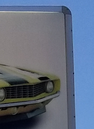

I have a potential customer wanting a flat polycarbonate face where this pan face currently is. Basic question but in all my years doing light boxes I haven't came across any with rounded corners. Just not common in my area.
Does the sign panel have to have rounded also or is it just rounded on the retainer?

Whenever I retro-fit a sign face I take field measurements first. Having the guys try to trim it in the field is inviting trouble (and is expensive). When you take the retainer off you'll see what you have to do.
When I do these jobs, I always try to get the client to re-lamp and do any repairs. More often than not I recommend an LED conversion. The biggest concern, of course, is will a flat face be far enough from the lamps to work? Usually not.

[Measure] how deep the existing can is. Next, just find the right vacuum shop to make rounded corner pan faces. Most likely, they're just clipped.

I'd give an estimate which includes the time to take out the existing faces and bring them to the shop to use as templates..

They don't HAVE to be rounded as long as they'll fit, but generally if the retainer is rounded the face is as well (at least every one we've ever run across).

Eh. just make sure your installer has a pair of pliers with him, and he can snap off the corners to fit :D

back to the OP, polycarb can be jigsaw'd onsite if necessary. no sweat. get a proper survey for your overall dimensions, and just round the corners before you fasten the endcaps back-on.
