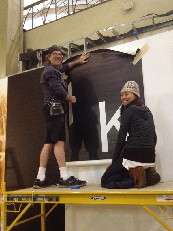

On smaller panels, I've always started at the top & once things were taped up in position, I'd get the first inch or two of release liner peeled & cut, allowing that top section to create my "tape hinge"
From there, helper & I would peel about half the liner, keeping print away from wall, and then carefully hand off the job of holding it to helper, to hold taught, and as close to wall as possible, without touching wall.
I would then do the squeegeeing while she maintained tension, allowing my squeegee to be what brings the print into contact with wall.

I think this will be a lot easier than you think. I have done a lot of these with 3M and Avery, never the vinyl you specified. Walls are low tack with the orange peal texture, but aggressive vinyl may want to pre-tack on the overlap. If the vinyl is stuck to the paint don't try and pull it up or you will pull paint. Typically if it hasn't been squeegeed your fine.
I like to use a laser level so the graphic doesn't walk up or down hill. You can use a level to get the first panel started and make overlap marks 3 or 4 places to make sure your panels stay plumb.
I usually install these by myself and will tape up the graphic and get in in position (several trips up and down the scaffold). Create a tape hinge 2' down for my first stroke. I always use a 4" squeegee with a felt cover for the top 2' so I don't push a wave or screw up that first stroke. Because the material I use isn't overly aggressive, after the top 2 feet are done I will peal 3 to 5 feet so I can make sure the alignment is spot on. One key with this many panels is keep adjustments to a minimum. Otherwise your adjustments compound and get worse as you go. Sometimes there are panels that don't have a lot that have to line up and you can correct it. The key is to keep the tension and how you install the panels the same.
Hopefully the graphic is at least 4" taller than the wall. Split the difference between the top and bottom so you don't have to worry about the graphic running up or down hill.
I usually use a 12" cheap plastic drywall mud tool with 2" Velcro loop on it (I couldn't find and image but its a weird shaped black one). I have and still use the the metal ones occasionally, but if your not careful you can burn through on a corner and damage the vinyl. Also, make sure you re-squeegee the edges because the wider squeegees don't get enough pressure and you don't want the graphic coming up.

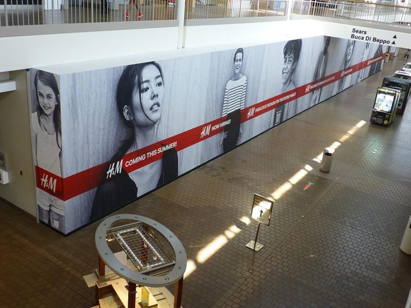

I just got back from inspecting the wall, and for some reason the contractors came up 2-1/2" short of 12' in most of the middle section, but the full 12' on each end. Not sure how to handle that just yet, but I expect I will just start my top out with 5-6" of an untrimmed print becoming my "hinge" instead of 2-3", and then I can trim it after the fact. (or just leave it floating, if it looks good, since it's just a temporary barricade for a shop under construction at the mall.. or stick it to the exposed metal top plate)
I still think it's pretty odd that they used 12' sheetrock, and had the framing correct at 12'.. because they had to trim the rock to F*** it up like this:
..well, I guess the photo uploader is broken here today... I click "browse" and nothing happens.. tried 5 times, but you get the idea, it shows the metal top plate in the center, and the sheetrock is 2-1/2" short of the top, but gradually comes closer & closer to aligning at the far end..

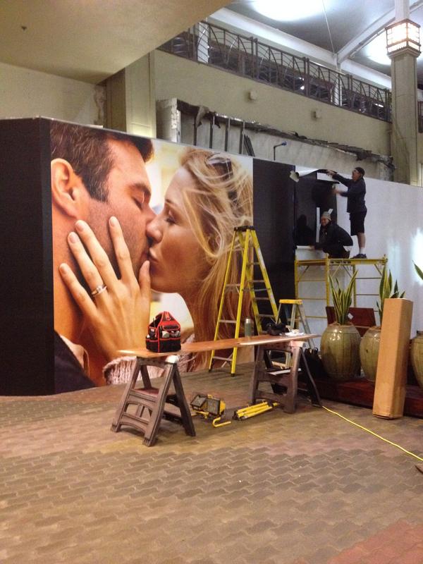

thanks to everyone's suggestions, the job went flawlessly!
