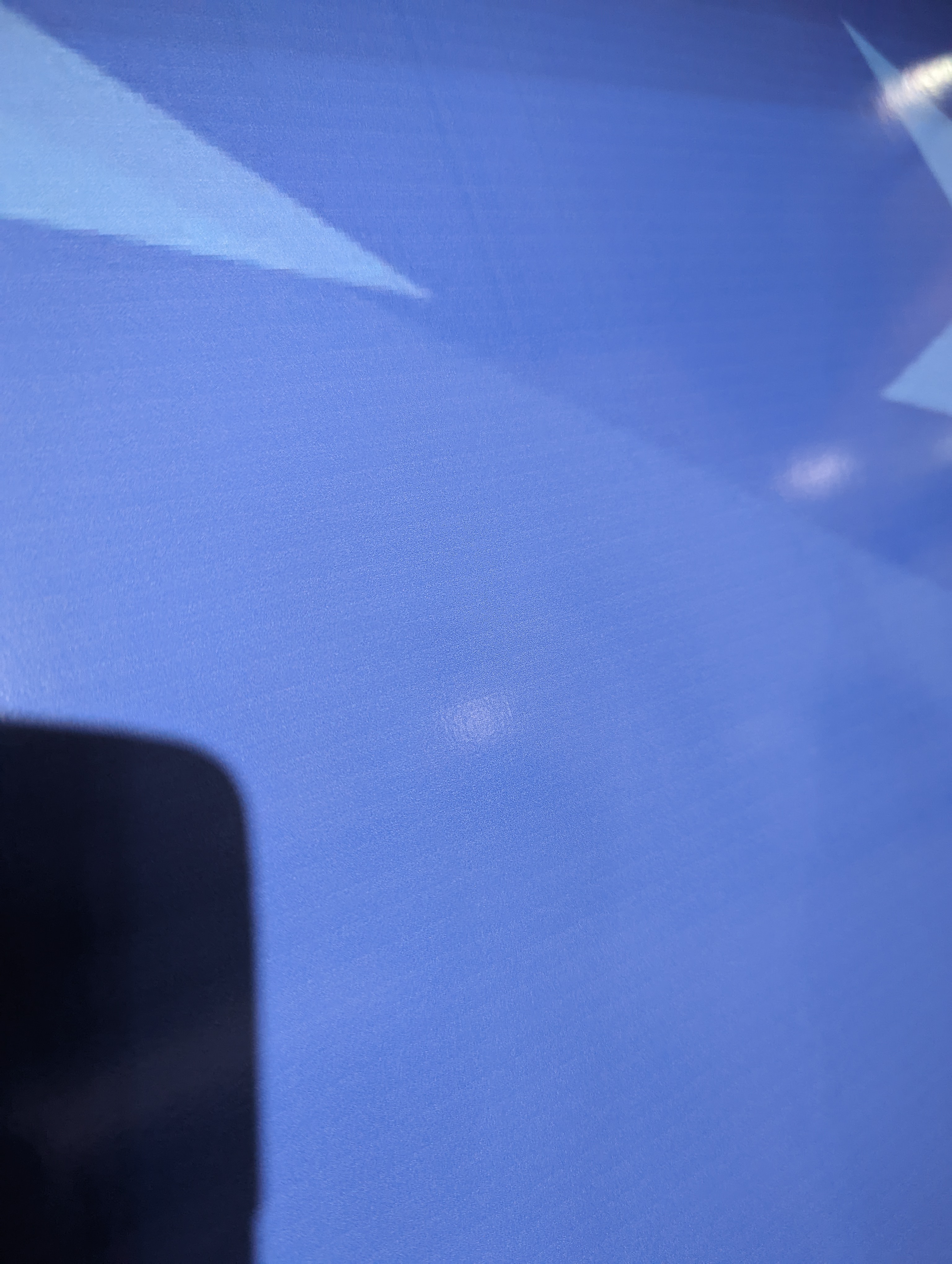

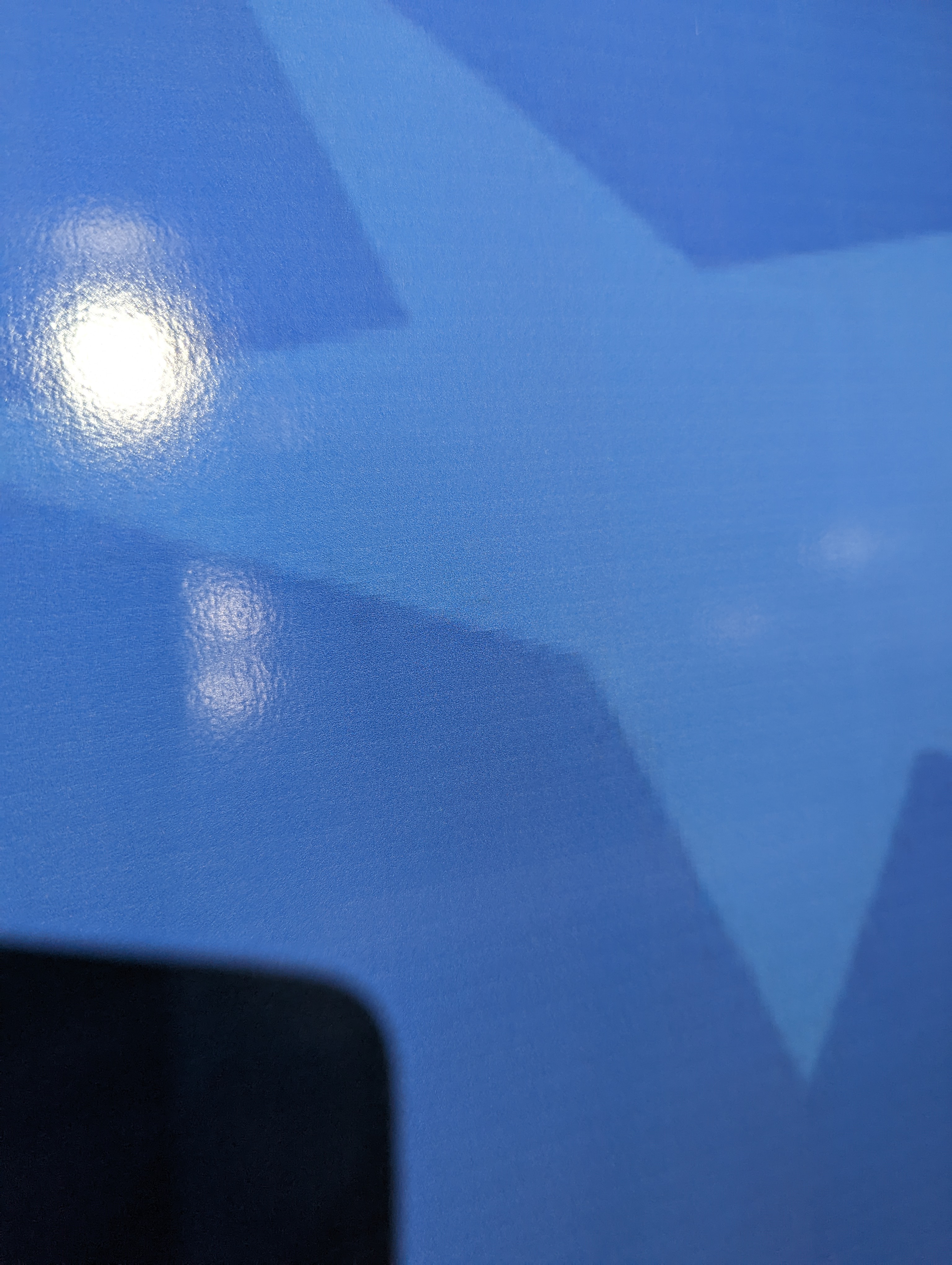

S60600 Horizontal Banding "lawn mower banding"
royalwrapz
I suspect this may be a combination of the media, relative humidity and head height causing static electricity to take out nozzles.
Try these three steps to isolate the problem. Ensure your heads have all nozzles firing before each step.
1. Ensure your head is not too high. The head height should be as close you can run without causing head strikes, default setting is usually good. Run a test of the problematic print and check.
2. Increase the relative humidity to 60%. I would expect to have static issues in such a dry environment. Run a test of the problematic print and check.
3. Change the media to something else. Some media are just static mills and can cause problems if step 1 and 2 are not right. Run a test of the problematic print and check.
From painful experience, it's easy for techs to spend days burning ink and media trying to fix a printer when it's really a setup problem. They are trained look for mechanical/electrical problems and ignore everything outside of the printer cabinet.
Head height is 1.6 lowest setting. I have also tried 2.0 and 2.5 just because.
I will check on the humidity.
Have tried many materials all same results

I recommend you outsource the blue panel file as a sample for yourself and any technician or salesperson to evaluate. If you purchased the so-called “demo” from a dealer, have them print the file and / or send the file to Epson. They should entertain that more an opportunity than a challenge. The exercise is almost guaranteed to be an eye-opener to all parties.
Of matters that are in your control, know that banding is primarily the fault of media feed adjustment / tension, uni-directional / bi-directional head alignment, nozzles, head height, and heater settings in that order. (Discounting operator errors using incorrect setups or media loading troubles and media faults such as sticky coating, physical damage, old age, etc.)
Such a consistent banding pattern is not indicative of environmental or static troubles. The first two points above are easy to troubleshoot and where focus should concentrate. Measure crop or trim mark distances throughout the roll because you say a print begins fine until later, it’s not.
Only if you find the time, maybe explain exactly how the auto and manual adjustments were performed,
Good luck.
I have sent a handful of files to Epson. They said they have printed them. They told me they had similar results. I asked for pictures and for them to send me the prints to look at. They told me they will look in to that. That has been months for the first printer and 2 weeks for this new printer. No answer on that. I have asked 3 different Epson employees multiple times. Makes me think they are not telling the truth. I have been catching them not being truthful. Epson is not happy dealing with this as they cant figure out what the problem is.
The tech ran adjustments on the heads in service mode. I have ran manual and auto feed and head adjustments. I have even setup a 500mm box in ai and printed and measured to make sure it is 500mm.
I can print and cut a 16' contour job no issues. From small pop out decals to contour cut graphics.
I think you're missing the point. He said nozels are dropping out... None of what you said addresses that.
Having 2 different issues. Nozzle drop out on older machine and brand new machine. Also having the "lawn mower" banding issues
Nozzles dropping out are usually caused (here) by the printer needing cleaned. If you're cleaning the head and caps correctly and keeping your maintenance kits replaced correctly this shouldn't be an issue.
After you sort that out, which by the way is NOT causing the lawnmower looking banding, it would cause "strip" banding where you notice a pixel missing every pass then you can move on to the other issue.

It looks like ink starvation, which we DO occasionally see in blues here on 4 pass setting on our S60600s.
We usually run everything on 6-pass to ensure no banding, except for banners or other things where banding wouldn't be an issue.
Yes correct. The older machine was cleaned regular and kits replace. This new machine is brand new and nozzle drop out was happening on same day as install. Yes def not causing the lawn mower banding.
I have used 4 different profiles for 3m 40c
Looks like ink starvation to me also. I have increased ink density. puts more ink down but same banding just darker.
When the first printer worked for 2 months it printed amazing at 6 pass

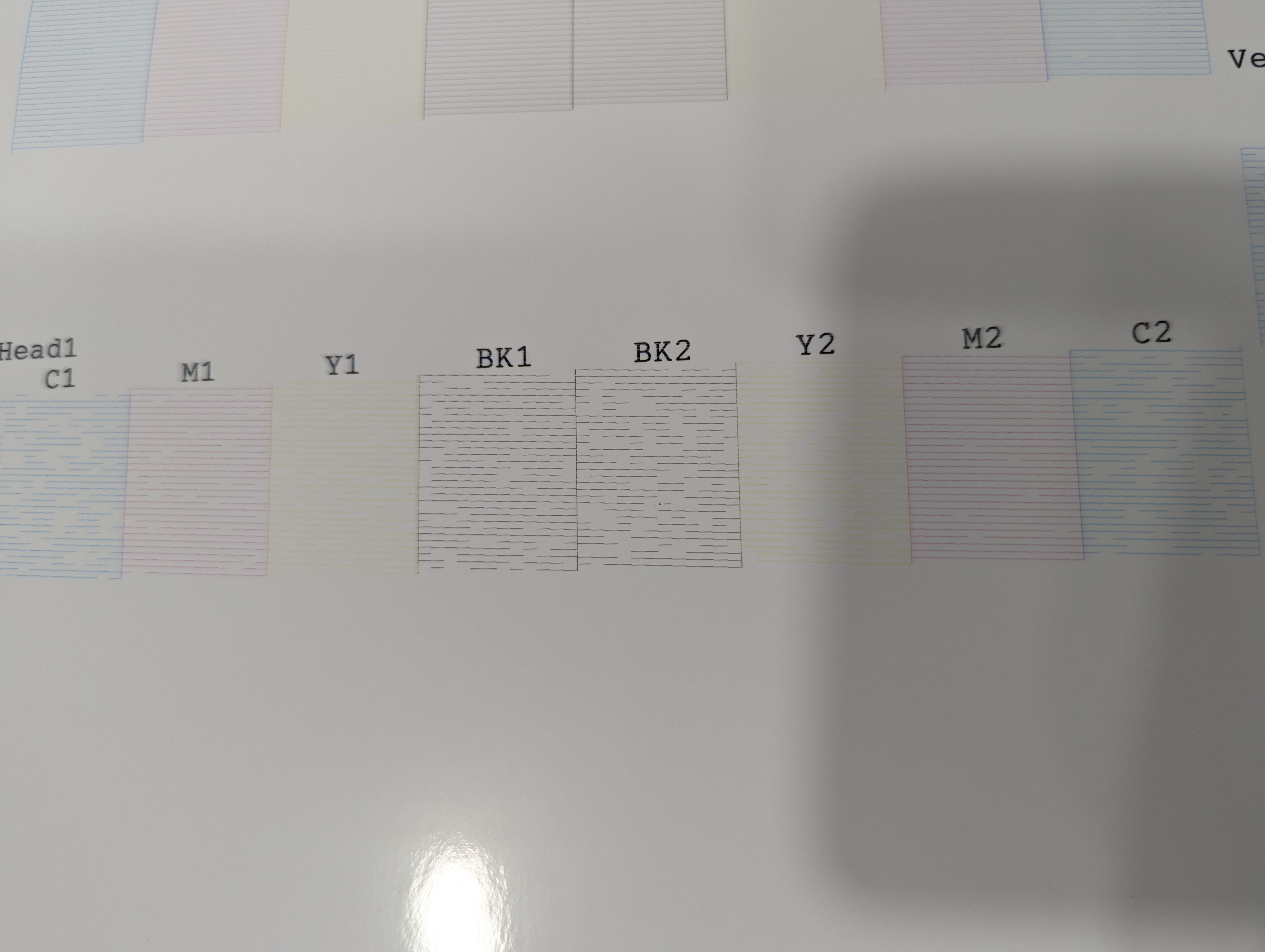

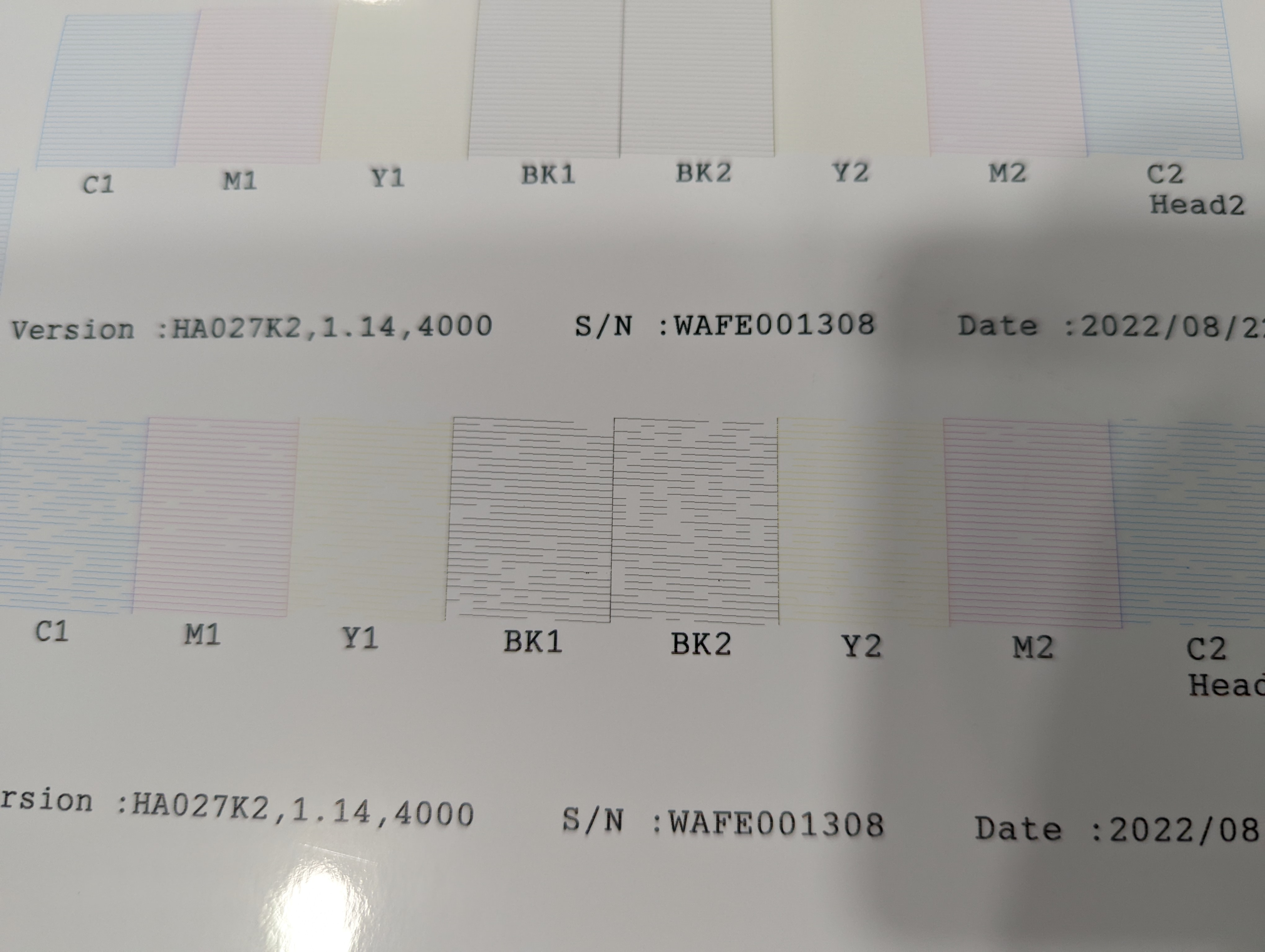

The tech came today. Ran some tests and made some head adjustments. It's helped with the lawn mower banding on 6 and 8 pass. Still visible barely. Said it's the best the printer can do on solid colors. And just print everything on 8 pass
And for the nozzle dropout. Said printing solid color is to much for the printer. Printer can't keep up. Try only printing 6 feet at a time.
During one of his adjustment prints. Nozzles dropped out quite a few. He ran a cleaning and they came back. His words were all you have to do is a cleaning and your good. I ask what about in the middle of a print and they dropout? He said don't print so long.
If it happens again call in.

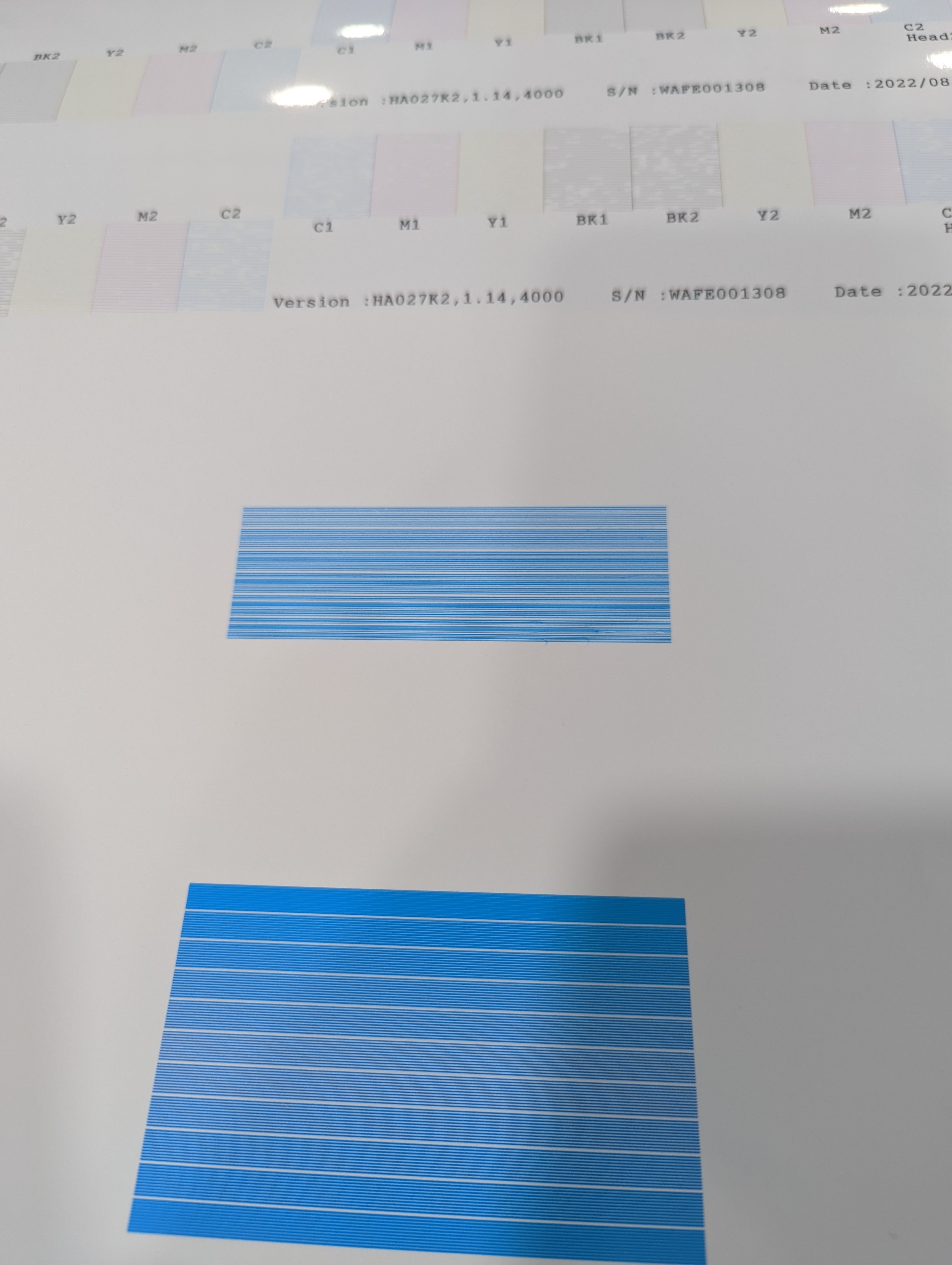

Epson told me my humidity and temp were off and causing nozzle drop out. They want it at 52% and 72. That has not helped the issues.
These were run this morning. Happened in the middle of a print. Ran a cleaning and started printing better.
Epson response
No one ever said that by raising the humidity it would help with this type banding that Jesus has already said will not be discussed and service calls will not be set out to address. SEC, our parent company has advised the printer is operating within spec. This you have also already been informed of by Jesus. Raising the humidity was done to address the nozzle dropout.
So this banding is normal and Epson will do nothing about it

This would be in line with what I mentioned previously regarding Cyan mixture colors and printouts. Had to basically raise passes up to 12 or 16 just to get less noticeability and better results for those smoother color blocks. The results would be in line with when the printer was newer with as low as 4-6 passes.
Have you tried different profiles? Could maybe help with something as well as test out the higher passes until you notice anything different?
If anyone else chimes in with similar issues of different degrees for any cyan-related colors or ones requiring more cyan mix, then we would have a consensus that this is a little more common for Cyan for some reason, either with the ink, the lines, or the head. (This also happens on brand new heads for me as well).

Also, depending on how often you use your machine, run cleaning a little more often if you don't use it as much.
It almost looks as if, given how your nozzle check is so bad prior to cleaning, your capping station might be not configured or seated correctly. This could happen as a result of maybe transport or anything during setup. Just maybe another possibility if it helps get a tech out.

I have sent files to Epson. They said the test files were similar to my prints. I asked for them to send them to me 3 different times so I could compare for myself. They would never give me an answer and finally said they dont have them.
Everything has been gone though multiple times. These pictures are in the middle of a print. Started out beautiful then nozzles start missing and this is the result. I paused the printer between panels ran a cleaning and started printing beautiful. Then again about 10 feet.
Epson is absolute avoiding this. I cant even get a return phone call. Tech or customer service.

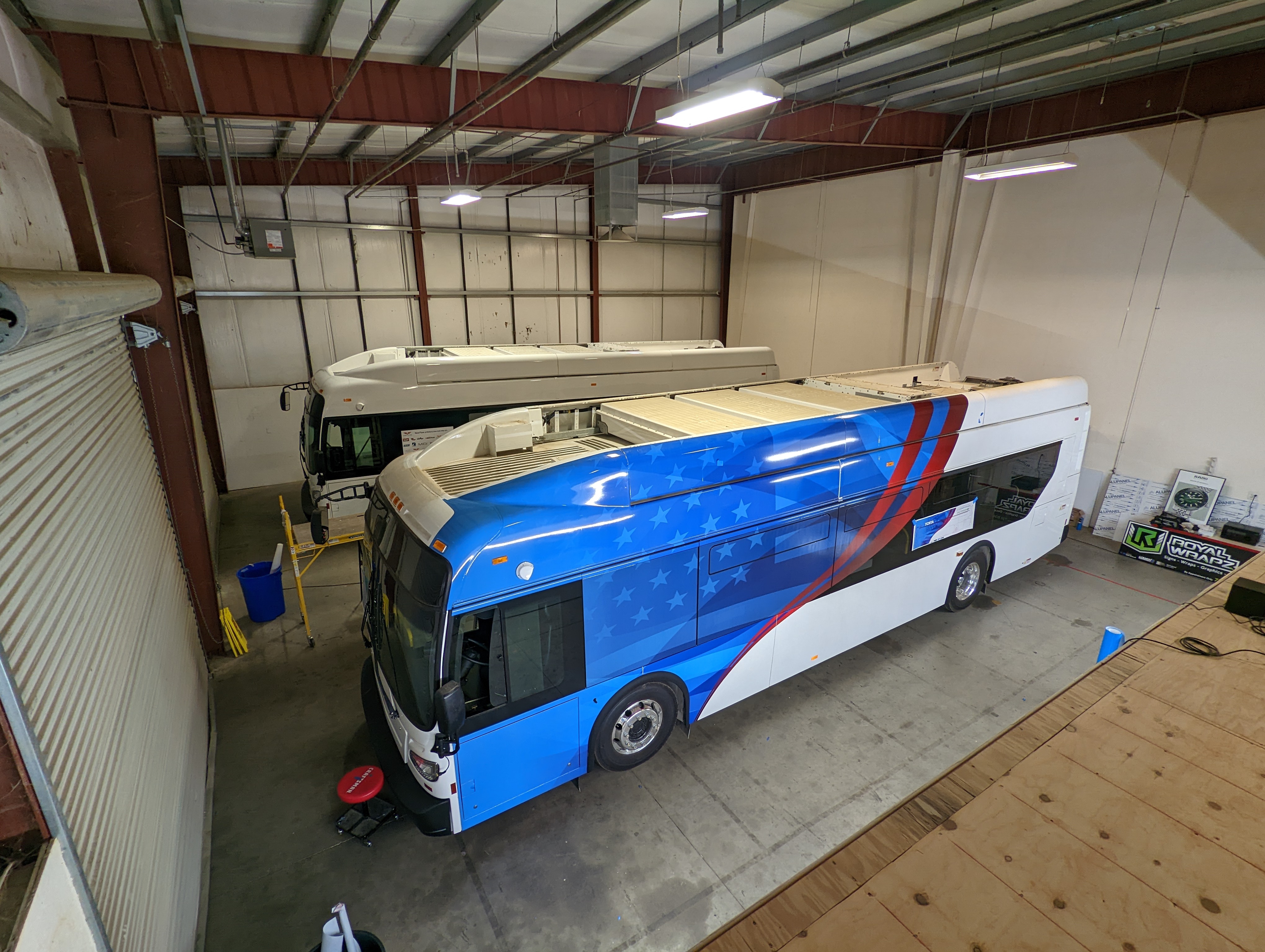

This is on a Bus 72
