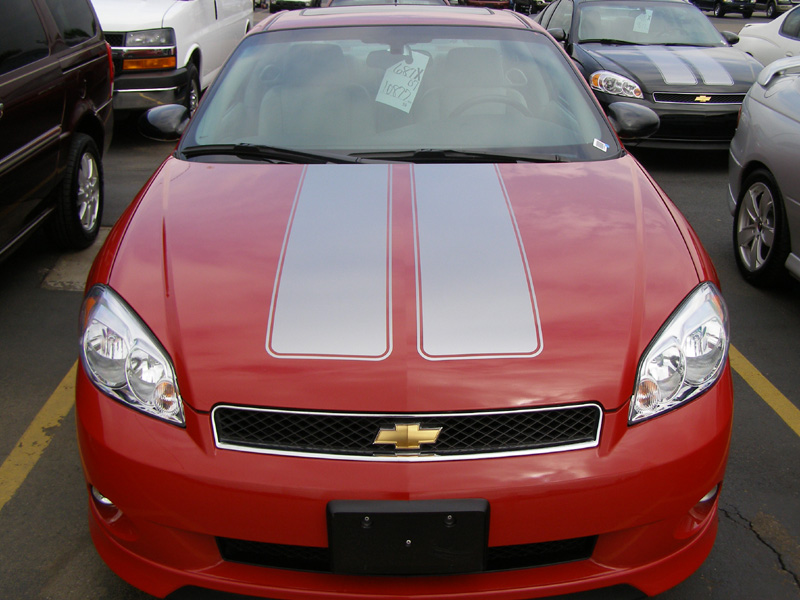

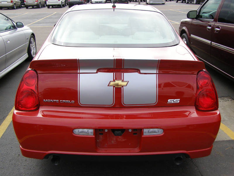

EndlessOptions
Shinerite
I use it a lot and love it. Did this Monte Carlo with it
