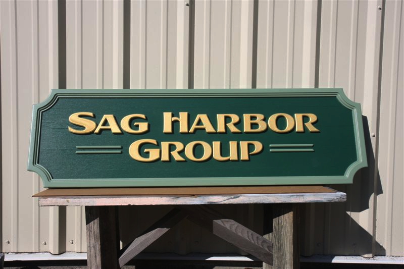

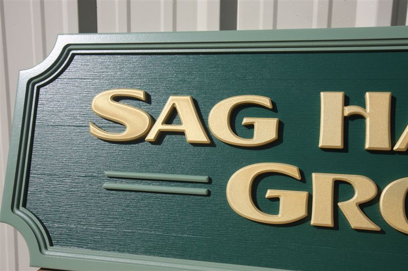

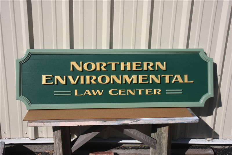

Here's two I just finished yesterday. They are pretty small, 18"h. x 60"w. These are for two attorneys in New York and will get shipped out today.
Made entirely out of PVC. Inlaid letters, CNC detailed raised border. The letters are Matthews brilliant gold with automotive clear coat on top. They're simple but easy on the eyes.

Were the letters made on a CNC also? Nice font as well, what is it? One day I will have a bigger shop and attempt work like this.
Craig Sjoquist
Really like the effect of the letters against the background, which seems your saying to get this sharp looking raised effect background and other lines is one piece ... the letter are separate and attach to background little confused but thats what I'm reading VS cutting everything out as one piece with CNC were you would not be able to get the under cut look.
Marlene
those are anything but simple! really beautiful! where do you get the woodgrain PVC (if you don't mind telling)
J Hill Designs
for the bevel on the text, what bits do you use? i cant tell if its a bull nose or a bevel on the letters...Vbit then a profile cut? explain pls :thumb:
