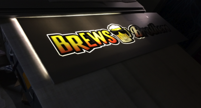

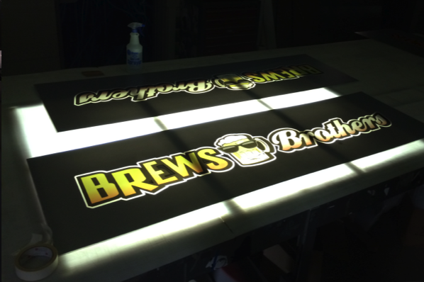

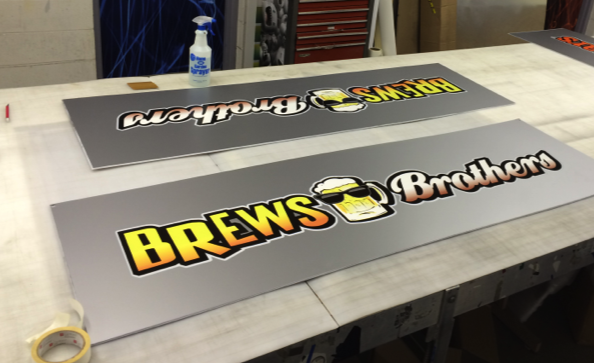

i make illuminated signage, for a living... and I don't bother to ask if they want dual-layered transluscent prints or not BECAUSE it looks like junk otherwise. Even if I tried double-striking the ink on a single-layer print. No way that would ever leave my shop.
Clients are willing to pay a premium BECAUSE it's illuminated, otherwise they'd be asking you for dibond and vinyl. Don't cheapen your reputation, and potentially scare-away future projects, by trying to save some ink/vinyl.
#justsayin'
for reference, pics attached: single-layer print (day), single-layer print (night), and then same print with reverse-print on clear and applied to backside of panel (night)
