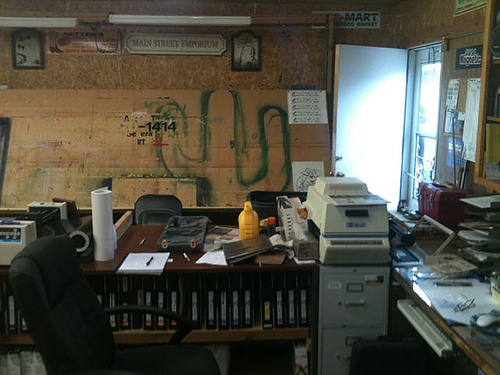

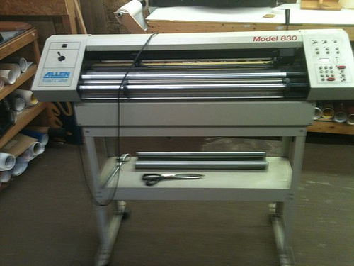

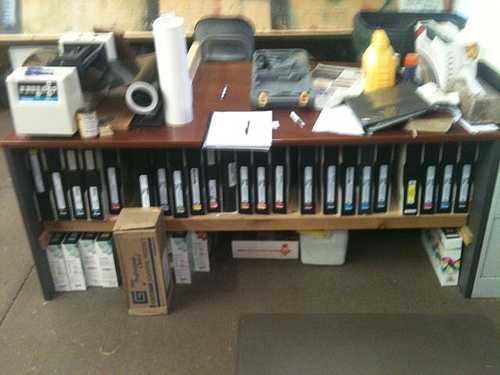

Pics
It all appears in very good usable condition.

Ask him to run it for you and listen if there are any odds sounds or clicking noises that shouldn't be there. Look at the quality of the prints for scratches and if all looks and sounds good, then.... sounds like a good deal :thumb:

All edges make wierd sounds, a better test is to print a solid 12'x12" square of a dark colour and another square with a 0-100% fade

Exactly. Unless you run an edge daily it's hard to tell good from bad, and even then the noises it makes can surprise you. If it prints good that's what matters. Those Edge LE's are great.

We still run our edge on a win 98 machine. It doesn't have to be blazing fast if it functions as a sort of 'rip' machine specifically for the edge & plotters...
Both the dongle and edge require parallel ports (Bi-Directional I believe?). The plotter likely a serial port. Something to watch for if you choose to upgrade the computer, or OS.
Unless something is wrong with the system, I would assume you can continue to run it as is, maybe having to put in another hard drive or something. Network the machine to send files to it and you're good to go.
3k sounds like a heck of a deal. we'd almost pay that to have a parts machine around... well ok, not really, but close...

Spoken like a man who has never owned nor operated a Gerber Edge so as to be aware of some of its unique and valuable capabilities. The original Classic and LE versions of the Edge print using a 300 x 300 print head. Later versions such as the Edge 2 and FX us a 300 x 600 DPI print head. As far as I know, there has never been a 150 DPI model.
Edge owners fill a void most inkjets can't touch such as spot color printing, white on clear, metallic colors with no fumes, color management headaches, dry time or lamination required.
This 1980's technology was originally introduced in 1994 and continues to command retail prices in my shop ranging from $15 to $35 a square foot. My 300 DPI Edge LE is far from obsolete and continues to earn its keep on a regular basis.
