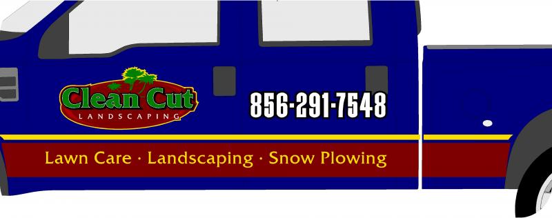

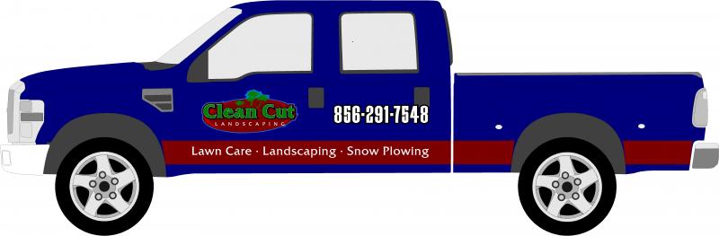

Hey guys truck I laid out for a client this morning, the logo is already set in stone I did not design that...they've used that forever.
Any critiques before I call him to stop in and take a look?

Why not utilize the stripe and put some text in it? If you are going to draw someone's attention to part of the truck - put something useful in there. Web address, phone number, etc.
Jillbeans
I can't see it either, too small.
Maybe try a white outline or even a pale blue outline around the logo?
It's hard to critique something you can't see.
If the maroon stripe is not part of the truck already I'd eliminate that.
Love....Jill

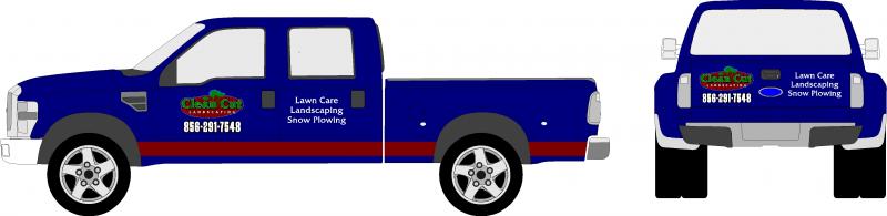

Although the layout looks neat there some things I would try or also present.
1.... phone # if area code were a thin stroke or took up less room you would have a larger 7 digits area code is only reference the 7 digits is what needs to have strength.
2... lawn care, landscaping, snow plowing .. might fit on bed length wise and larger.
3 ... a 3rd option place logo on man door, phone# on back door, menu on bed should allow everything to be seen better and a good flow.

Stripe is painted on the truck already. They had it at a painter around here for almost a month waiting for them to put the logo and phone number on and all they did was paint the stripe. Needless to say they didn't leave it there any longer and now I have a truck with a stripe...
Edit: Panels are removed from the doors on the side so they won't be in the way.

I like the last layout better.

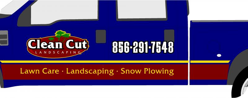

Heck go for an eye popper - stripe (1/2") the maroon with a golden yellow (PMS123) and outline the logo with the same yellow. ???

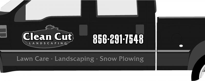

Convert to grey scale, and then you'll see what the challenges are with the legibility of the logo. You've already stated they won't change it, but it's a shame and a wasted opportunity for the client.

Thanks Dan! Agreed it is a wasted opportunity.

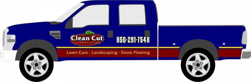

Ask them if they would consider changing their name color from green to white.
I like that! Thank you Jill, calling them now.

The stripes are nice but copy in them is way to low.
Your there is many wraps with copy low and it looks like garbage, why cause you 1st want your above center and also do not want your eye falling off the bottom plus when low like that you do not read it. You always want copy away from bottom of any sign advertisement which very few designers even think about it unless they are experienced.
