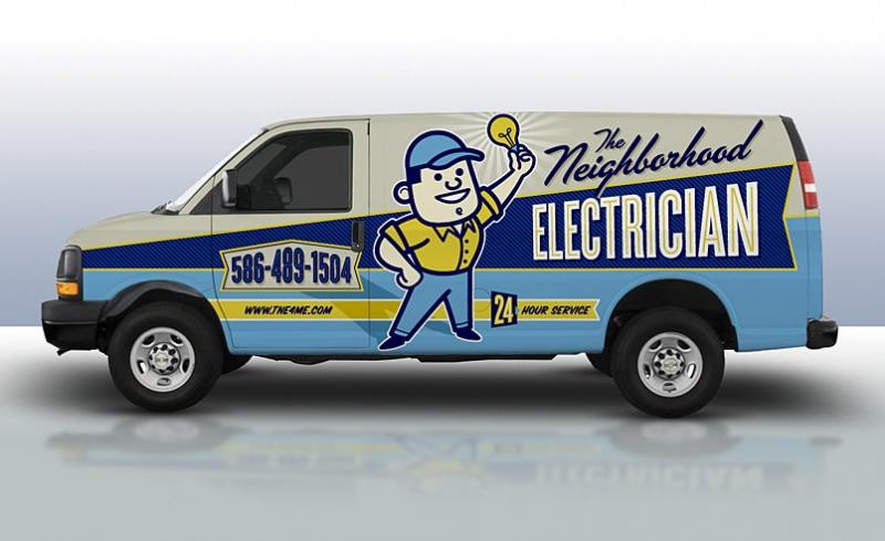

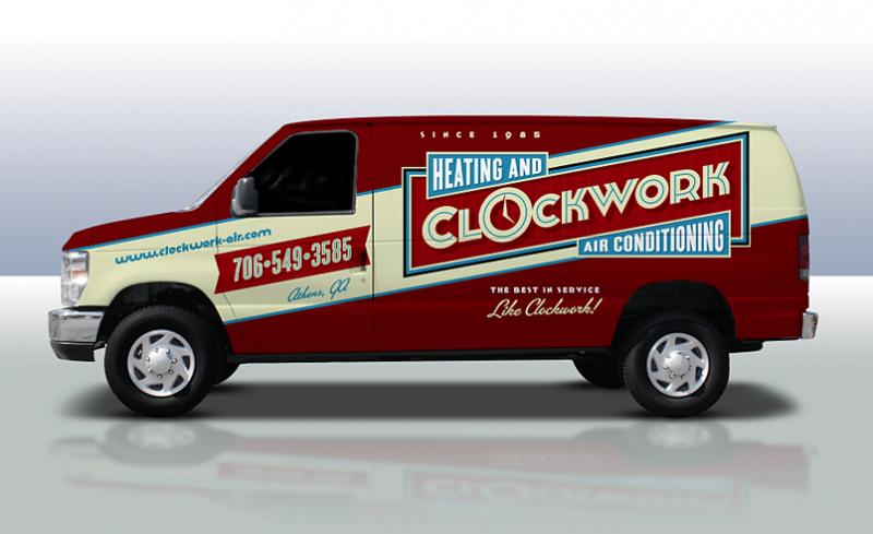

Here's two new wrap jobs that should be done shortly. We had a lot of fun on these ones, and clearly I'm loving working with the retro genre. We're blessed to be getting a lot of calls for this specific type of work, and it's a lot of fun to research and execute this style.
I had a question on the printing of these, which maybe someone can provide some guidance on.
I was a little concerned about printing of the solid fields, and were they seam up. I recently had my logo printed (the arrow) about 66 inches wide, and where the seam was, the solid colors did not match up perfectly. So I was a little worried about the abundance of solid colors and if it prints horizontally, if the color on the right edge of the vinyl will match the color on the left side. Someone once told me it had to due with the printer being 'warmer' by the time it prints the next panel (or something like that).
Anyway, just wondering if its something I might be concerned with, or if its a non-issue. And if there's anyone that can print and install these for my client - one is in Michigan and the other is in Georgia, please PM me or let me know. They are looking on their own, but I might prefer someone who's quality I know.

megacab
i'm diggin that electrician design. couldn't have nailed that retro look better with it. :U Rock: just looking at it makes me think of a diferent time. has a superb customer service feel to it. can't explain it exactly, but it's a home-run.:thumb:

Hey Dan. With some of the older print technologies this was an issue, not all the time....it was just random.. which is why we moved on, and bought a latex. This thing prints the exact same color, on every single panel. Just finished up a few full sized e150's, no color difference. Had a customer who we did a wrap for 3 weeks ago come back, needed something patched, cause she hit her car, was a solid pink... reprinted the same pink.. same color no problems. Overall you shouldn't have a problem with the solid colors ending up being different. Make sure you find an installer who can line up that line pattern fill....

Love the designs, but I'm curious as to how they work on the passenger side?
The electrician's one has a version of the logo which is mirrored, so that one works perfect on both sides. The HVAC one, I decided to have logo break the plane of the angled striping so that I could carry the stripes to the rear and keep it symmetrical. Not quite as ideal, but still works OK.

Those look great Dan. Is that a chin dimple? Might look better without.
