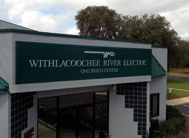

Don't normally work on the weekend, but weather forced me to do this install on Saturday to meet a deadline for today. There is a new awning going up right beneath the sign and that would have made for a really difficult install with it in the way.
Sign is 4'h. x 20'w. Used to 4x10 sheets of alumalite and framed it with 3"x3" aluminum angle. Letters are prismatic and painted with automotive metallic silver.

did you put the 2 sheets together, and then join them with some type of adhesive, and then fill it, sand it and paint it...because i don't see any join... Very nice job.

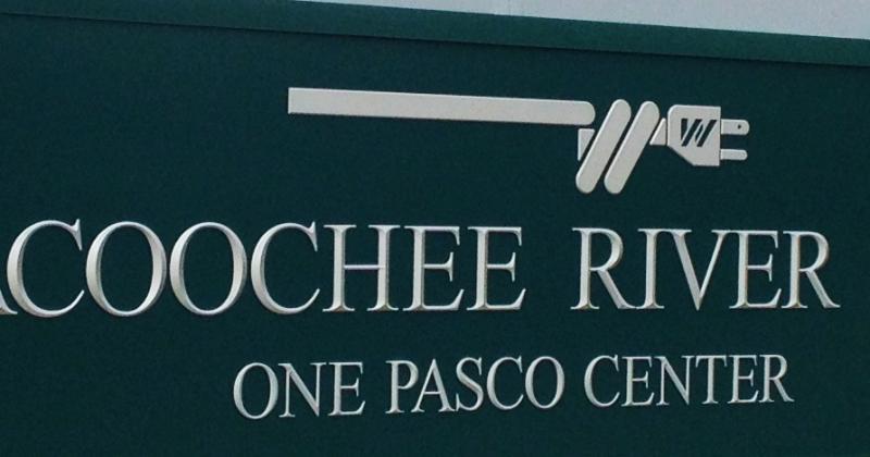

Are those ceramic letters, or vinyl, or what?
Just 3/4" PVC letters we made and painted in house. And to answer the question about the seam, it's too tight to even see from down on the ground. Just made sure we had perfect edges to butt together.
Ohhh! Nice! How do you make those PVC letters? CNC, or ?
