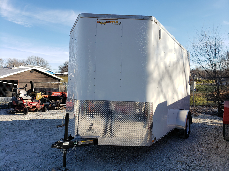

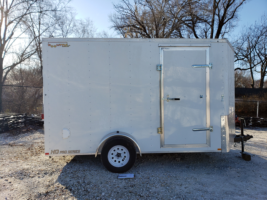

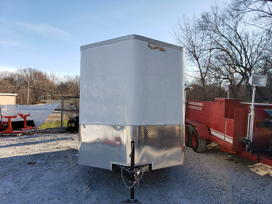

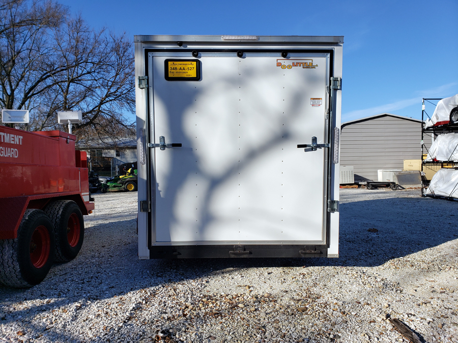

So that brings me here. I want to make sure I price this project fairly so I'd appreciate any solid feedback I can get with regards to pricing this job. Installation tips and tricks are more than welcome also.
I'm attaching images of the trailer. The area we are wrapping is around 210 square feet but I'm figuring as much as 240 sq. ft. to account for some trimming. We will not be wrapping the V nose, just the white painted areas on the sides and back. It is brand new so we plan to install under the screws and also plan on removing all silicone beads from around the trim and replacing with fresh clear silicone after the graphics are installed. I've calculated around $1800 for Oracal 3951RA+ProSlide w/ Oraguard 290 gloss lam and $1200 for labor ($50/hr. shop rate and 24 total man-hours - 2 people installing x 12 hours each). I'm leaning toward adding an extra $300 on top of that for profitability (PITA reward) and/or a little extra cushion for anything we might manage to mess up along the way. So my total estimate would be around $3300. I know every market varies but does this sound high or reasonable enough for a 12 foot trailer? We are in Central Illinois if that helps.

Sounds very fair for you being it you first time doing it and not bad for your customer. However, I think shops which do this more routinely, would be more around $2,200.to $2,500.

That would be high for my area, we would be around $1800 for the 2 sides and back, plus design. We wouldn't remove the screws either, just go over them.
If you want to learn, this would be a good job to hire an installer on and shadow him and see how he does it.

It shouldn't take near as long as you are planning. I'd be 1800-2k and go over the screws too. We all have different philosophies but I don't think is really fair to charge extra for a job you are learning on if it is something that you want to get into. You are probably better off giving them a decent price but telling them that they may have to live with some flaws due to your inexperience with wrapping. Then you wont have to stress so much over redoing things.

I wrapped that same trailer a few years ago. I think I charged $1200 (install only) and remember it was a little light... but I also did the front and basically a color change... had to do the sides of the back and remove hardware.

We would be in the $2,000.00 - $2,400.00 range printed and installed for our area. I too think you are a little high - but maybe this customer won't mind? However, if they are already doing wraps as part of their marketing, then they probably already have a base point to go by as far as pricing. You don't want to miss an opportunity by over charging.
*FWIW - another thing to consider is to hire a wrap installer to do the install for you. A competent installer should be able to knock that out in about 6 hours or so by themselves and still charge the same or less as you are planning to charge your customer -AND- will be sure to do a good job of it as long as they have good references.

i think some of your price difference may be in the vinyl: appears as if you marked-up 50yd rolls of media, printed&laminated, but two 54"x10yd kits would be more than enough to cover i think.
make sure you don't leave vinyl bridged over the panel seams. apply-over it with your tiles, but trim those lines flush to the panel. tile/overlap on flat panels if you need to. Even though they're screwed-down, those panels shift/flex in the elements, water gets into it, dirt gets trapped under it, and the vinyl bridge will self-destruct faster than you'd think.

Pull the Rivets. On a trailer this size it will take a part timer 30 min to remove. Wrapping over them will take a considerable amount of time especially for the first time and you may end up with issues later that the customer won't be happy about.
Remove that vent cover. Put a section of vinyl on the top of it to make it blend with the rest of the wrap.
Consider your time involved in removing the vinyl decals currently on the trailer. These sometimes are unlaminated or metallic and they are a pain to remove. Steamer works best.
Slow down around the wheel wells, hinges on the doors and those back door "lever/handle" areas. It's extremely easy to make a bad cut.
The door side will take at least a half hour more for an experienced installer usually.

We have to do the sides on the back as well. I have to go look at the trailer closer in the next few days to see what is actually removable. I'm assuming I'll have to cut and work the vinyl in around the hinges and whatnot. Did you find quite a few items to be removable? I'm not even sure what I can do about these stinkin' air vents that protrude from the sides.
I'm actually already very aware of this. Ask me how I know. Hahaha!
