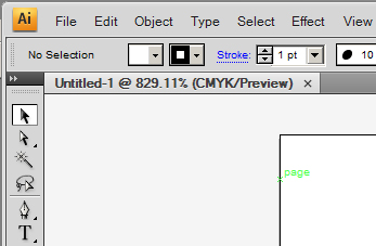

There's pages in my copy of AI. That's why I find it confusing. Why do I need an artboard if I have a page? Why do I need a page if I have an artboard?
Here's a screen grab of what pops up when you hold the cursor over the edge of the page.

signswi
Must be pre-multiple artboards, CS3 or older? Illustrator is so much better in CS4+ that I forget about the era before it.
signmeup
Nope it's CS4. It's called a page in the help files when you type "page" too.

The page is considered the printable area. Let's say someone orders a 24x18 sign. You lay it out on the 24x18 "page" or whatever you want to call it to make sure it all fits properly. The "artboard" or area around it is the area that can contain other shapes or junk if you will. I have seen alternate logos/art dragged out here. Or unused shapes. This can also be considered the bleed area. Anything outside of the page/document does not print and is cropped out

That's how I figured it. What's the grey area for? I can draw stuff on that and it won't print either.
I have a feeling that knowing what these three separate areas are and are for is critical to understanding the work flow to this software... something that eludes me so far.

Huh? What 2 areas don't print? Only the area outside the white (bounded by the thin black line) won't print. For those of you that are confused... earlier versions of Illustrator are not gray but rather white. Only differentiated by the thin black line that shows the size of the page/doc size specified when starting a new document

Here's what I see. The "page" is the little, tiny square black outline, the "artboard" is the white square and the "grey area" is... the grey area. I can draw on any of them. The coloured rectangles are stuff I drew.
Only stuff on the "page" will print.

I am not sure about the confusion. The last time I used corel draw (v10) there was also a non printing area. The page/doc/sign area was represented by a white box with a black outline and drop shadow(for effect and to appear like a sheet of paper I guess). This is no different in Illustrator. Anything outside of this area gets cropped off in the print preview box
