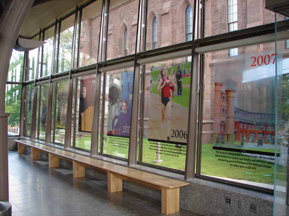

I'm bidding on a job similar to the one pictured here. This is not a photo of the actual job or design. It's an indoor application on glass walls. The client would like to use clear vinyl and would like for the printing to be sort of semi-translucent. The glass portions need to remain as clear as possible.
It kind of looks like the attached prints were done on clear vinyl on a printer with no white ink. What do you think?
We don't have the capability to print white in house. As such, I've never tried to print on clear material so I have no idea what the results would look like. I'm assuming they'd look something like the attached image. If you were in the same boat, how would you handle this job? would you print this job yourself or sub it? What material would you use? What overlaminate would you use to avoid haze?

Looks like it may be a matt clear vinyl, etched glass vinyl or maybe even just printed directly to a clear lam. Nothing in that photo shows white ink. Either way, those prints look great.
heyskull
I would print onto matt clear and maybe at a double pass just to ensure density.
I would do a few test prints to test the way this prints.
Also one thing your client must understand is this effect will only work if the interior of the shop is white or very bright!

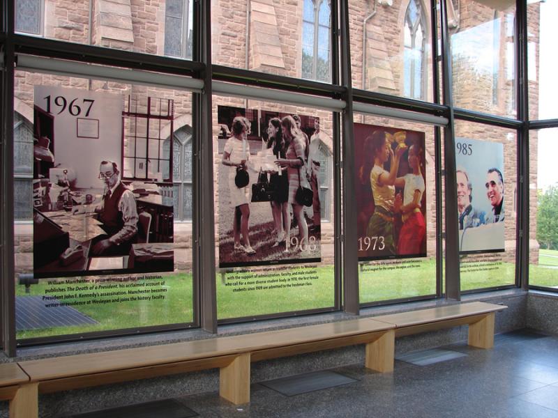

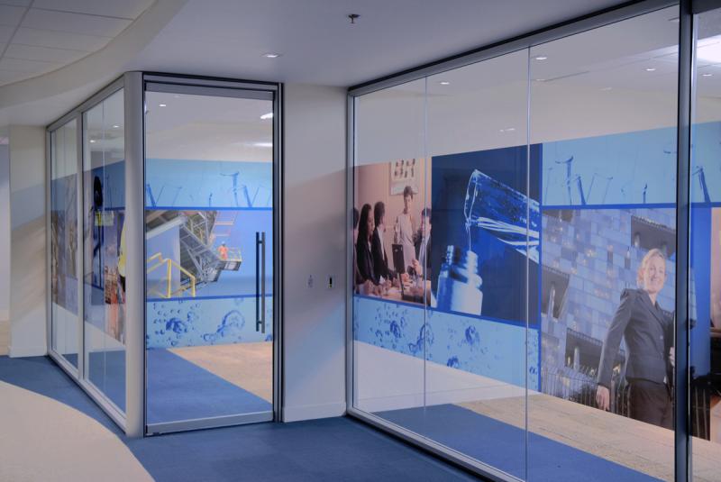

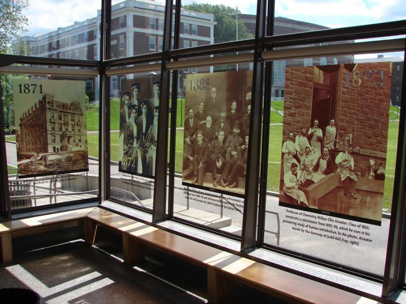

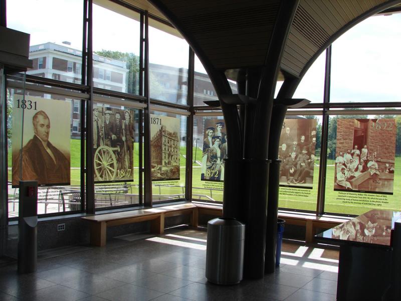

That looks like some nice stuff. Available in Australia? I am curious to ask my supplier if there is anything we have here that's optically clear and printable. Most stuff is ok, but I mean almost pure clear. I heard it's around, but didn't get to catch the name of it. Thought it might be a 3M or avery product.
heres some pics.
Media is 100% optically clear

Anicom
I agree with cdiesel, the Mactac B-free products are fantastic and while the "clear" is not 100% optically clear it's impossible to tell if the graphic is full coverage. The air egress means dry application without any bubbles, the only recommendation I have based on our experiences is that it's even easier to apply when lamninated with either a clear gloss or a lustre if you want to add some translucent properties to it.
MikePro
reverse (flipped) print on clear, back laminate with a dusted/frosted crystal vinyl and apply 2nd surface.
grafixemporium
Beautiful Merritt... perfect solution. Is this laminated? I'll shoot you a PM with square footage and see if you can quote it for me. Thanks!
