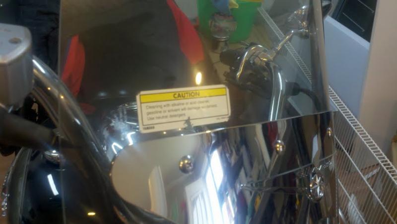

So I have this annoying sticker on the windshield of my motorcycle that I want to get off. Its on there pretty good and I dont want to damage the windshield.
Any suggestions?

local hardware store sells plastic scraping tools that rival metal blade scrapers. Helps a ton to delaminate the graphic, and whatever adhesive remains can be scrubbed away with any citrus adhesive remover.
ProWraps
if its a paper decal, saturate it with wd40. then it will just wipe off. should cause no damage to your windscreen.
Fred Weiss
Merchant Member
Steam would be my first choice. I would be cautious of the alcohol suggestion if your windshield is made of polycarbonate. They don't get along.
Yes it is a plastic so I would think alcohol and razor blades would be a bad mix.
It is just a paper decal but I would think wd40 might damage the plastic no?

Paper decals are removed using your honey's hand lotion. Smear it on let it set a while and it will come right off.. Adhesive and all.
phototec
denatured alcohol and a razor blade.
DO NOT USE ALCOHOL on plastic windshield, also I would avoid razor blade (it scratches).
My Harley windshield had special coating and alcohol took it off?
WD40 & fingernail works best (or old credit card)!
