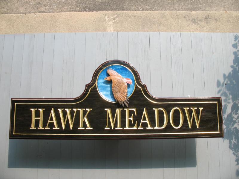

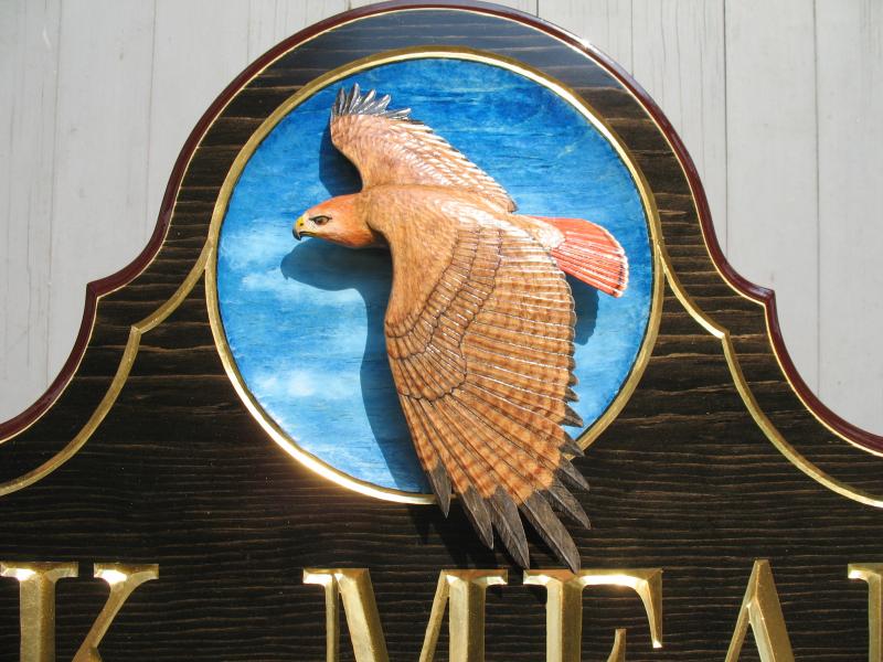

Just finished this. All eastern white pine, 5/4x52" long. Stained black with 5 coats of poly.
The bird is 5/4 thick and 10" high. All hand carved....no sanding and stained with stains that I make and coated with poly. It is mounted off the ground with stainless steel screws.

Outstanding !!
Is the bird connected from behind with screws or do you just rely on good glues.
I would imagine you pegged it or biscuit jointed it with glue, but I was just wondering ??
mrchips
Thanks everyone!
Gino, the bird is attached with 2 stainless steel screws from the back.....no glue.
When it needs re-coating, the bird can be easily removed to make the process simple.

Detail work is over the top, looks like something I would want to keep inside out of the weather.
Thanks for posting up an example of a real sign.
