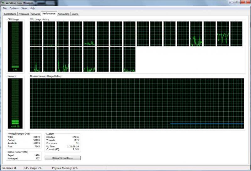

I have steadily upgraded the Precision Workstations we have. The oldest, the 690 is now maxed out but it still is a butt kicking machine. My newest one is a T7500 (there is also a newer generation of the Precisions now as well) which I just recently upgraded to dual Xeon X5650 processors and will soon upgrade it to 96GB of ram (currently at 48gb), this one also has a 500GB SSD boot drive. The Xeon X5650 is a 2.66ghz 6 core with 12mb cache - and mine is running 2 of them so I now have 12 cores or just under 32ghz of processing. Task manager is a hoot - since these also support hyper threading Task Manager sees an additional 12 cores making it look like the system has 24 processors. :Big Laugh
Another thing with consumer class i3/i5/i7 based systems, they are single socket so they cannot run dual processors. They are however less expensive than Xeon based systems. Anyways - I ramble too much sometimes but I don't like reading mis-information. On the subject itself - me personally, I'd strongly recommend an SSD for your system.
It IS a bit tricky though on these. You have an on-board SAS Raid controller as well as an on-board SATA controller. You will need to make a couple of changes in the computers BIOS to set it to boot from the specific SATA port you connect the SSD to and due to the server class chipset you will need to set the SATA ports to IDE mode while you clone the current boot drive, then set it top AHCI mode when you are going to actually switch over to the SSD. It's not as simple of a process on these than on a consumer class machine. The best method is really to start from scratch. Just disconnect temporarily the existing drive, install the SSD, set the BIOS to boot from it (in AHCI mode), and install Windows 7 x64 from scratch, get that running, update drivers, then reconnect the mechanical drive and that will just show up as another drive with all the old data on it. Of course you still would have to re-install ALL of your programs, RIP, etc....
