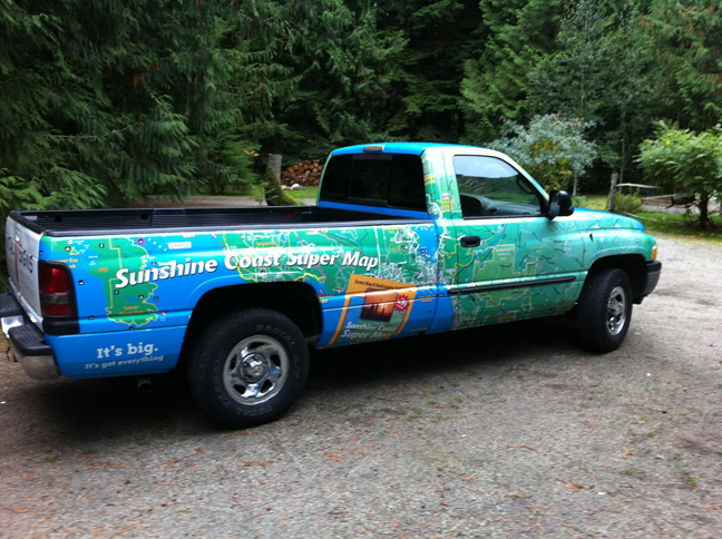

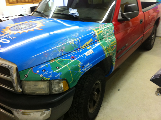

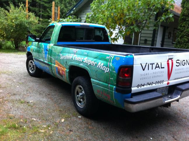

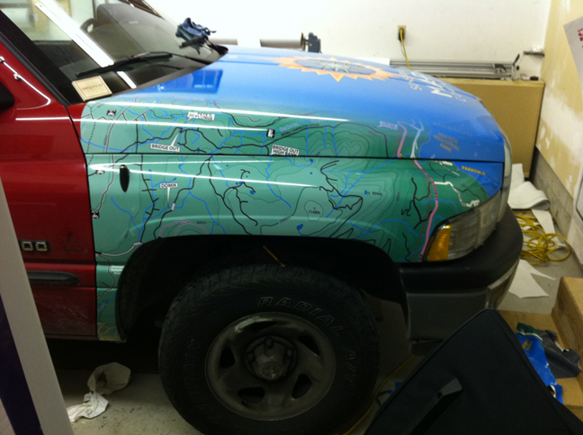

Hi All,
So, I have had my sign shop for a month and decided to tackle a dream. I have been making a recreational map for the area where I live and for many years and I have always wanted to wrap my 2001 Red Dodge 1500 Ram Pick Up in the map. I started the job this Friday and finished on Monday morning. There are very few people in this area that do wraps so I figured that this my opportunity to advertise the 2 things that I do. Make Maps and Signs and I guess now wraps!
I learned a lot from this forum. The views, opinions and ideas got me through this and for that I thank you all. I did run into a few problems in the beginning, but after several hours of working with the material I managed to make it presentable. Frankly, when I drove to the corner store, when the job was half done, I felt I was in a parade.
Thanks again, you guys (and YouTube) gave me the knowledge to pull this off.

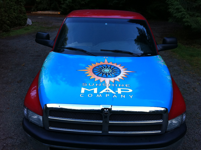

signmeup
I like it mostly. The tailgate's a bit odd to me.
I think it would have been better with the hood emblem on the doors too.

signmeup
That's why I mentioned the emblem on the hood. It's not obvious what he is trying to sell or who he is. The business name on the door would have been a nice touch.
Dan Antonelli
I think you missed an advertising opportunity. The problem with the graphics is you need to be 3' away for them to make any sense. From a distance or driving down the road, really hard to discern your message. I like your logo and agree as Signmeup stated that you should have made that your primary branding on the side of the vehicle.

I really like the concept. I agree on the branding though, the logos on the doors is obvious.
Do you have a web site? It seems "SunshineCoastSuperMap.com" would work great, and I would try to pop that text off the background more.

GypsyGraphics
Love the hood and you did a nice job aligning a difficult graphic, from the hood to the fenders.
my concern is the placement of text... to low to see on the side back end and the phone number on the tailgate is almost impossible to read.
totally agree on bringing the logo onto the doors, that'll look really nice!

tcorn1965
I am by no means qualified to critique as a professional, as a citizen though the tailgate makes me think yours was wrecked and replaced with white one. I love everything else. Talented 4 sure!
