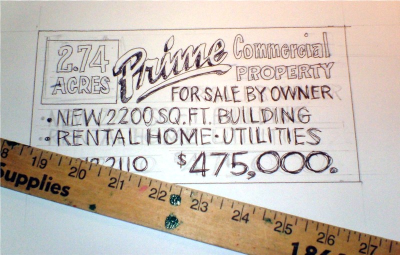

Day's definitely taken your original panel idea and done a good job with it. The only thing I'd say is the number needs to be much bigger and that box moved up to allow another line of lettering beneath it.
As far as what to highlight? I think you're forgetting to treat the sign viewers as idiots, Jill. For Sale still needs to be the focal point to get their attention and the phone number second, so they can dial or write it easily. I usually do all the other gobbley goop in a bullet format, so it does busy up the sign too much. People can pull over to get that info, even though we know they won't and this guy is making a mistake putting all that on there.

I would lay it out to read as:
FOR SALE (drop the "by owner")
prime commercial property
X acreage
new (X# sq ft) building with rental house and utilities
price
phone #.
Notice i switched "with" and "and" for the rental house/utilities.
Personnaly i would drop the "by owner" because really ..... who cares!

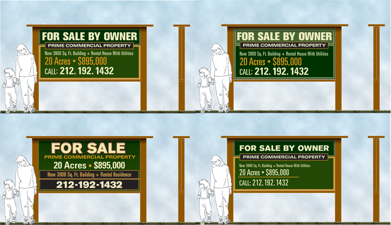

I like to make my leasing signs architectural, the added cost is not that high, and you can sometimes pre-assemble and drop it in.
I also add a scale person to convey the idea of scale and proportion.
I have done a few graphic standards for large commercial leasing companies, one thing they had was a solid background for their copy area, FOR LEASE and PHONE NUMBER were usually the main read. If color was added it was generally on the copy and maybe some color band somewhere. There was a marketing reason for it and I went to some marketing meeting once about 12 years ago... my eyes glazed over with all the info so I can't tell you the reason they had. I would make 2 layouts, one the way the client wants it, one or two the way I thing it should be done.
On the smallest copy on the signs shown, the copy is 3" and 5 5/8" tall.

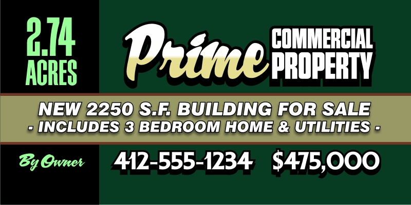

Jillbeans
Here is what I drew up this morning as a rough thumbnail before going to see this guy today. I have known him my whole life so I don't think he's gonna rip me off. Going to try to talk him into losing "rental" and adding a bedroom amount or something. Rick those are exactly the colors I was going for.

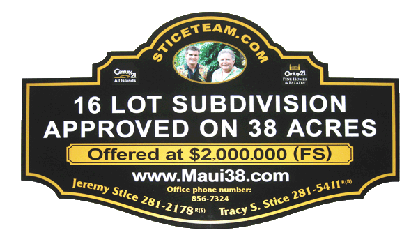

iSign
Here's a 3x5 I did last month.
I was going for "classy" too. It's 1/2" MDO, 1-shot and vinyl on a "Vector Art" panel...

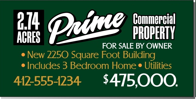

Jillbeans
Aw heck Bob, the guy asked me out when I was 15, was my brother's best friend, and I was not allowed to date till I was 16. You know I gotta give him some lovin'.
I won't go into price in the open forum, but he quibbled a bit. Then I said, "Hey listen, if it sells the property for you, it's worth it."
Got the deposit check.
Is this OK? Kinda based off my sketch. To me, it's really lacking something.
Not sure if it looks better with SQ.FT. or it spelled out, and I was able to convince him not to put that rental part in there.
He liked highlighting the acreage and the prime part.

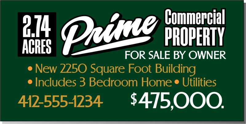

SignManiac
Looks really nice Jill. The only thing I might change is to lower or make a tad smaller the commercial property in the upper right corner. My eye seems to be pulled up there and that might even be because Prime is pointing up to that corner.
The fonts are great, easy to read, nice prioritizing of that much copy, and the colors are perfect!
Here I went ahead and made the minor change!

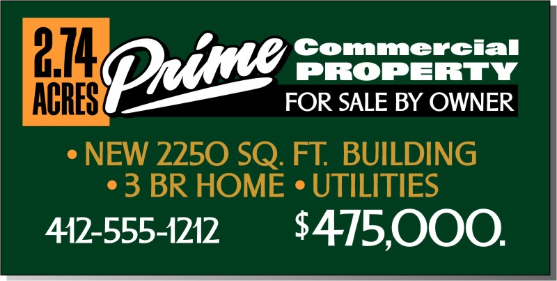

Jillbeans
Really?
The more I look at it the more I really hate it.
I think it needs a border, but that might be tricky due to the way the guy is installing it.
Back to Corel!
Jillbeans
OK no border, you talked me out of it.
Better or worse?
Maybe getting too Halloweeny.
