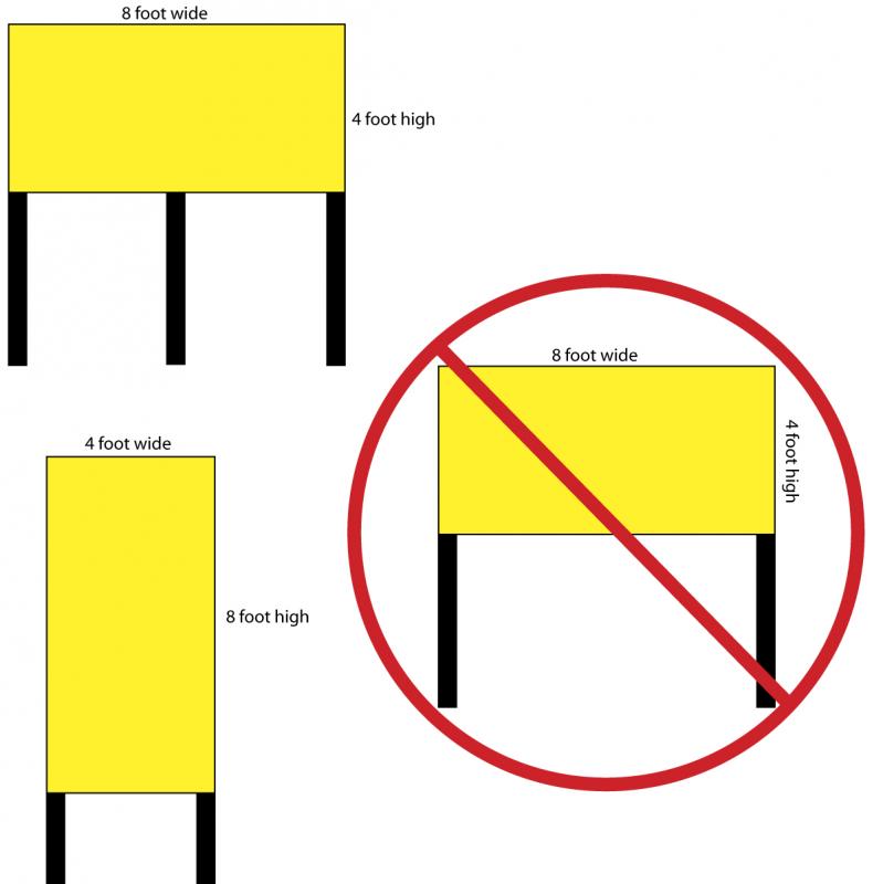

10 mil is fine. DONT NEED TO BRACE IN THE MIDDLE!!!!
If your going 8 feet wide x 4 high you have to brace it. You take anything that wide and with that much surface area only braced on the sides. Its going to fail bad. Its just not strong enough by itself sitting in the open.
Now if your going only 4 foot wide x 8 foot high then you will be fine.
I made a drawing for you to understand me better OP since you can't read very well apparently.
SO lemme get this right... 4'x8' is bad when braced on both sides, but 8'x4' is fine when braced only at the bottom? Same surface area. More wood to buy + deeper hole your way.

You don't have to put the posts all the way to the end of the board. Bring the posts in about a foot from each side. That will give it more stability. No braces needed. 10mm coro is perfect for the job.
Ponto
+1.... this... (and I've never seen a 4x8 "braced" in the middle either....

the only time.. the ONLY time you would need to use a brace is if you use 3mm dibond.. and if that's the case, you're using the wrong substrate. 10mm coro and 1/2 inch mdo is just fine without a brace. Sorry addy.. no bro.. just no
