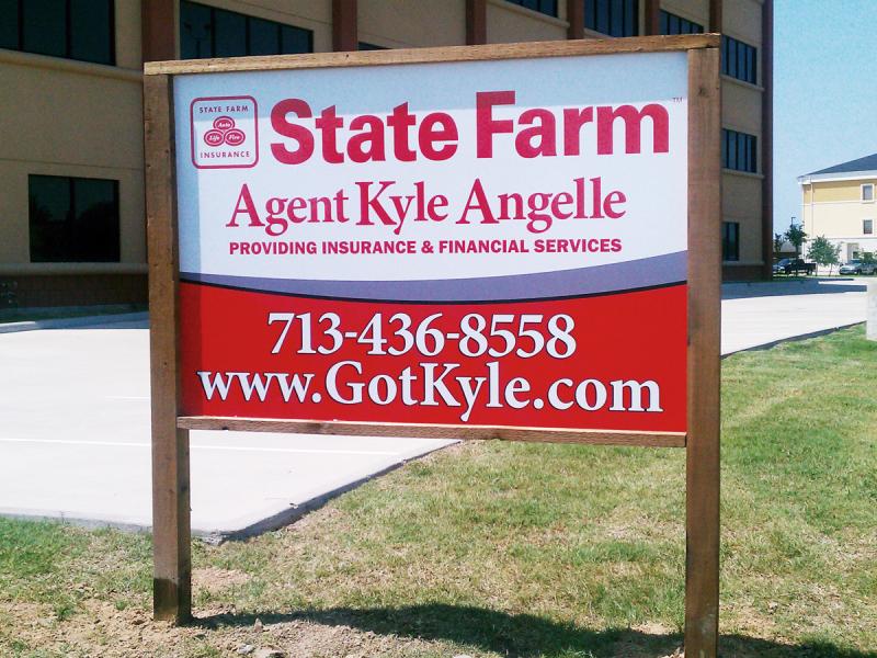

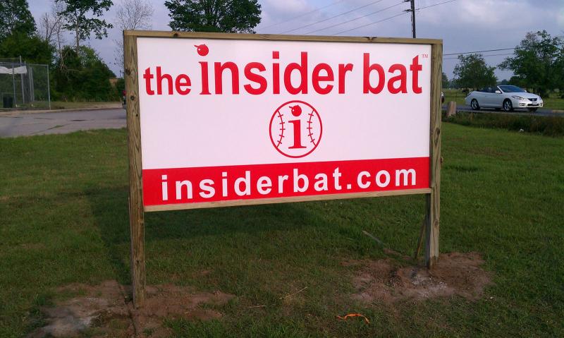

We don't do them often, but when we do stick 4x8's in the ground this is how we build them. Route a 1" deep channel down the middle of each 4x4 and 2x4. Stick your substrate in there and pop some coated deck screws in to secure it all. These particular signs are built using 1/2' ply. However you can do the same exact thing with alumacor or dibond. The 2x4's don't really add much of anything to the overall cost and the finished product is rigid and looks really nice.
Very nice, my wife will love yours .. in another life she was probably an Amish carpenter ... thanks for pics!
is the wood in your State Farm pic just natural (untreated)? It looks good, not as green as treated lumber usually does.

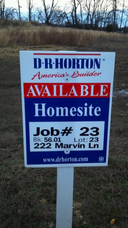

On my lot signs I buy untreated 4x4's as it is cheaper and I figure better for the planet, plus they want them painted anyway. If they can't sell a house before a painted 4 x 4 decomposes they have a bigger problem than my 4x4.
On my "lot marking" signs I've been using 1 inch fender screws which I paint white.... btw on the topic of screws I've found drywall screws really bore into the word great, does anyone know why the drywall screw's box says don't use on treated lumber?
Treated lumber has chemicals that will oxidize the un-treated screw failing them sooner and to keep people from getting the cheap screws for the outdoor decks that they were not intended for.
