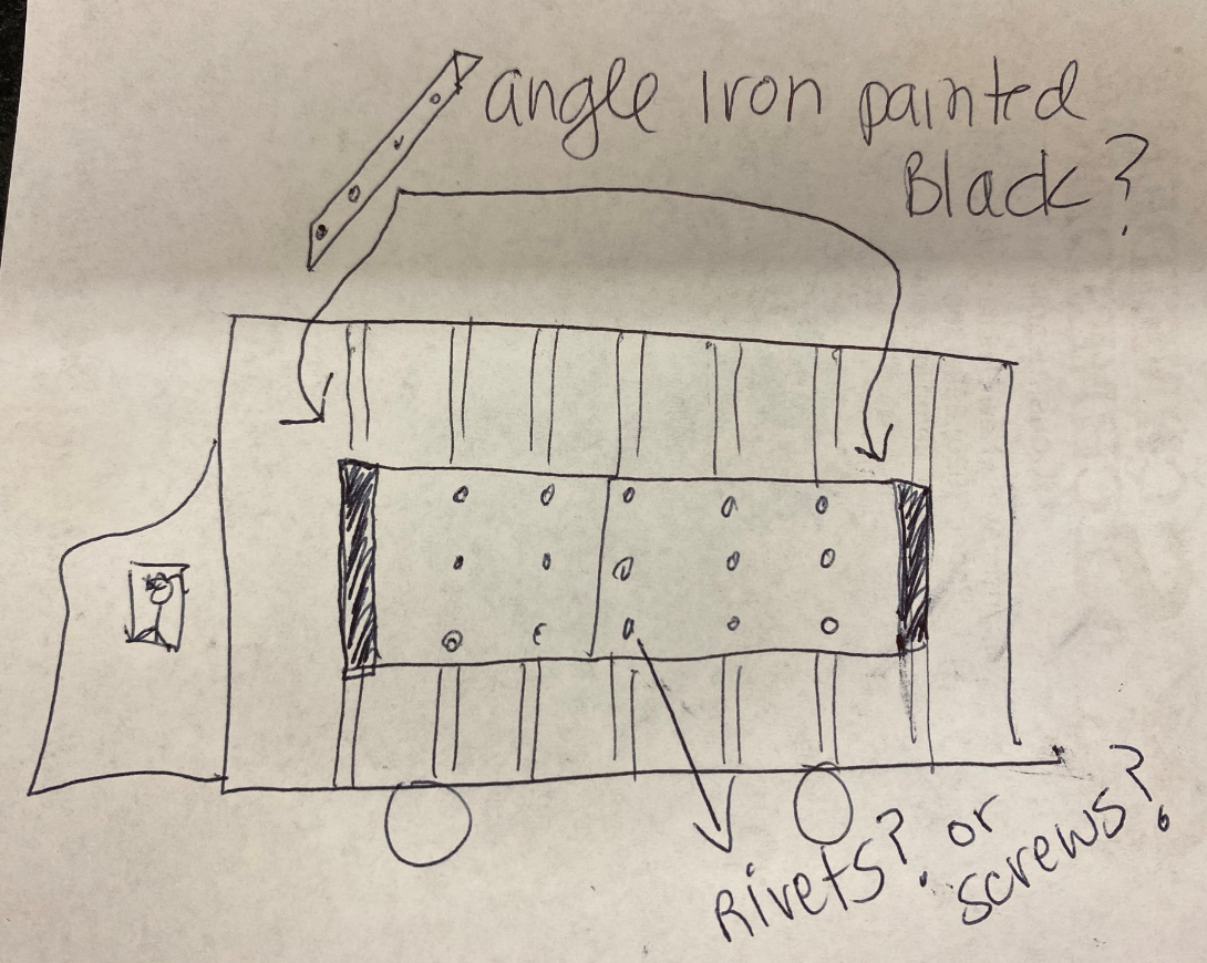

A couple of you are talking about angle iron and frames. Is this what you mean? Also, I don't have a rivet gun, I would prefer not to buy one if I can get away with these roofing screws as Bill said. When you say rivet or screw, you mean directly to the ribs right? Will the ribs be wide enough to butt the sheets together in the center - I will have to wait until he gets it to know for sure.
Screws or 1/4" structural rivets like mono bolts. Harbor freight has a good 1/4" pneumatic rivet gun for under 100 bucks. We have a few of them, one is over 10 years old.

I checked out another truck here that also has a sign. They welded angle sort of like your picture but to the ribs behind the sign as a flange. Then they through bolted the sign to the angles but only on the front and back. Then used regular pop rivets down the center which all failed (heads popped off), then welded the sign and the welds cracked. Good thing they have it bolted.
Ahhh...this is very good to know - it's starting to sound like a variety of attachments is necessary to make this bullet proof. Interesting the welds cracked...
