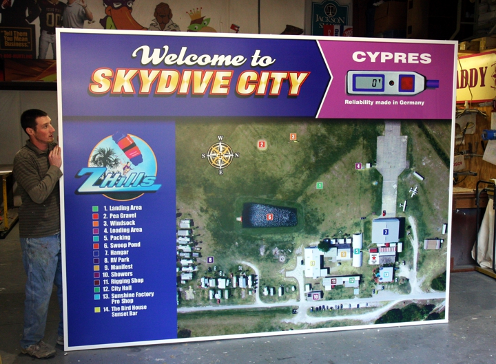

Just finished this off. It's 8'h. x 10'w. direct printed on two 4' x 10' sheets of DiBond for the skydiving center. New visiting jumpers can use this to figure out what the DZ looks like from up above and where the facilities are located. I designed it for CYPRES, one of the sponsors and a company based in Germany. Going to install it tomorrow on a block wall.

I made a frame from 1" square aluminum tubing with a center tube running horizontal through the middle where the seams butt together. Double sided foam tape along the surfaces and then framed the entire perimeter with 1"x1" PVC outside corner molding. It's light yet very strong. Will hang with cleats and four screws to hold it in place.

That's a good idea.
Not that I'd ever skydive, but I'd sure as heck want to know where to land.
I think the pond needs some angry alligators.

Looks good.
Skydive Las Vegas had a handout like this when I went for the first time. My dad always said he wanted to skydive so on his 50th bday I bought him, my brother and me tickets to fly. My dad then said he always wanted to but the older he got and the closer to death this didnt seem as fun as before. Needless to say. I have jumped 3 times my brother and dad zero. At least I enjoyed it. The next thing I want to do is bungee of the Stratosphere.
