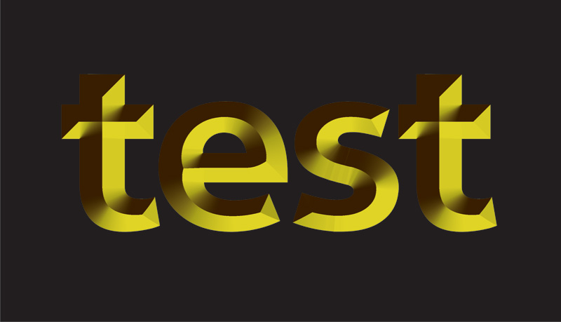

signmeup
You can do this in Illustrator? I'll be gall darned... um... how?
(I have CS4)

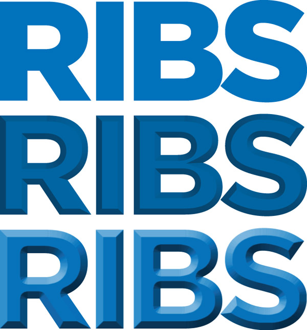

I wish the various bevel filters in different vector and raster based graphics programs could properly control how the bevel reacts to corners and grows to the center of the stroke.
The attached example, "RIBS," shows some of the problems that occur -especially in the letter "B". The lettering at top has no bevel, the second line has a vector-based bevel applied in Illustrator CS5. The bottom line has a bevel effect applied in Photoshop (with the usual bowled out rounded stuff happening).
One could spend a lot of time in a 3D modeling program to make some proper looking prismatic beveled letters. Or they could be carved by hand. I haven't seen any computer-based filters do the job fully correct.
I wish people who made signs with cnc routers had software that would do letters properly too. I always cringe when I see dimensional lettering that looks like your B.
Can you do a bevel all the way to the bottom of the letter like in my sample? In CS4? I can't figure it out. It stops at about half depth, like you show it on my computer.
