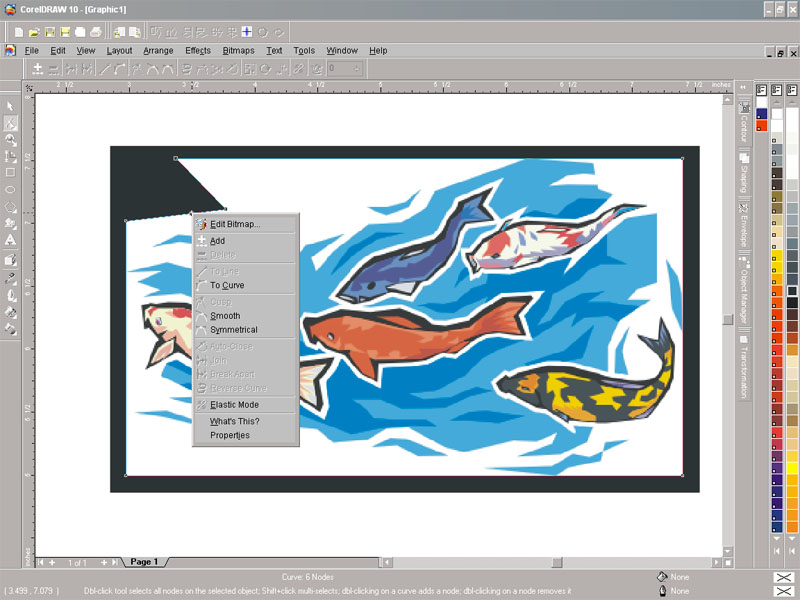

Shovelhead
An alternative to transparent bakground in COREL.....
is node editing, just like a vectored shape....see photo

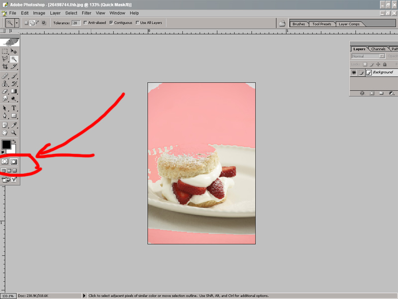

Shovelhead
Well....
I believe the question was concerning COREL.
But if we want to venture into Photoshop.....
a mask is applied (the pink area) and then you save as a "TARGA" file.
