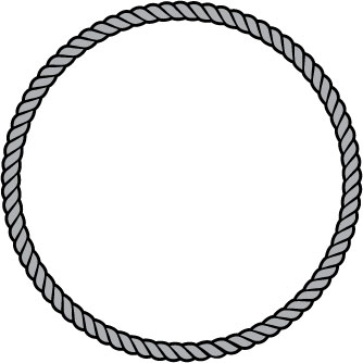

same technique works to produce a rope border

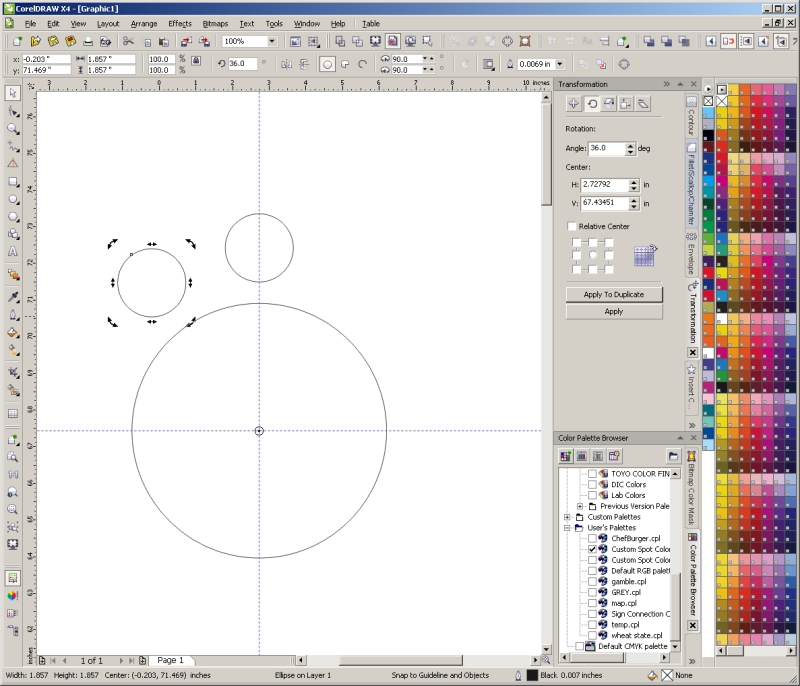

I draw the table circle and intersect it with guides. position your chair circle, square or what ever shape. With snap to guides on, double click the chair circle and position the rotate center point in the center of the table. then open transformation/rotate docker. Divide 360 deg by the number of chairs you want. Enter it into the angle box and click apply to duplicate until you have enough.
I use this to make gears, revers starburst...

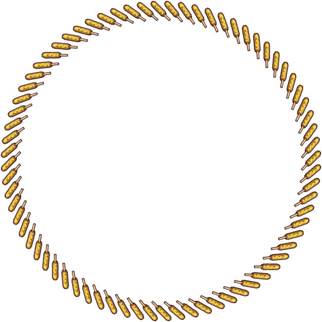

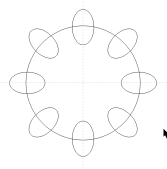

works for corn dogs too....
