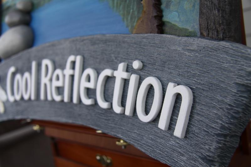

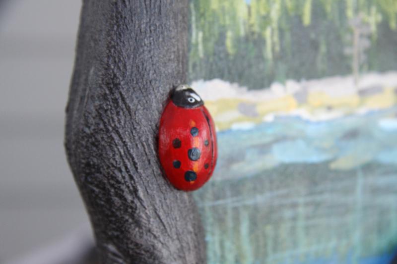

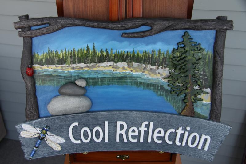

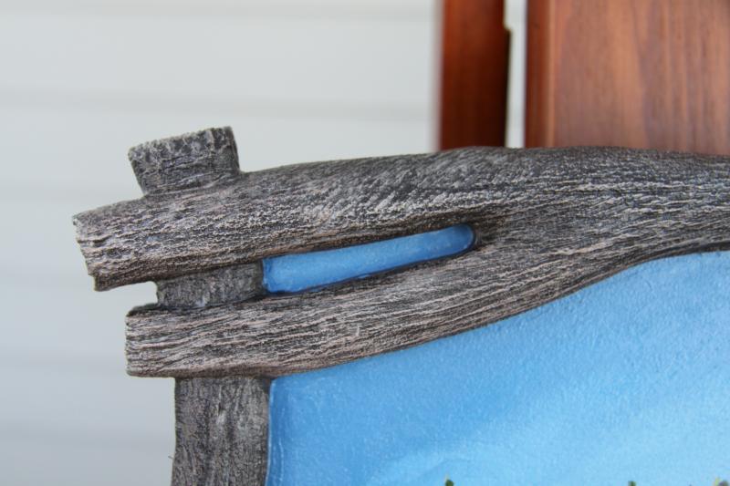

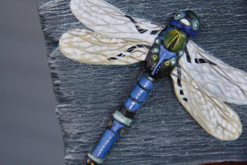

You are probably getting sick of me posting my signs by now, I find this site addictive am I the only one?
Anyhow here is a smaller sign 20" x 24" Cottage sign, this one I used a little sculpt to make a couple of the elements I think they turned out OK,

SkyHigh, the wood look is done with wire brushes and starts with a black wash to get into the deeper cuts and then multiple glazes of colours, and then a very light brush over with white or off white to pick up on the top surface to give the final depth I am looking for.

i had to look at your website too to check out your work! I love what you do! Is everything really hand carved? No cnc router?
piccadillysigns
Yes slapkiss everything we do is all hand cut, textured, carved we have a lot of hand tools, odd ones and hand made, we have just the very basic woodworking tools in our shop, It takes time and we love it :)
