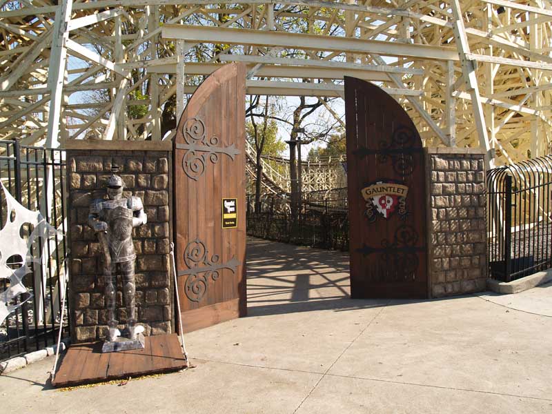

Looks great! We used the exact same technique for these wrought iron castle door hinges.
Takes a lot longer than you think to totally cover with dimples.

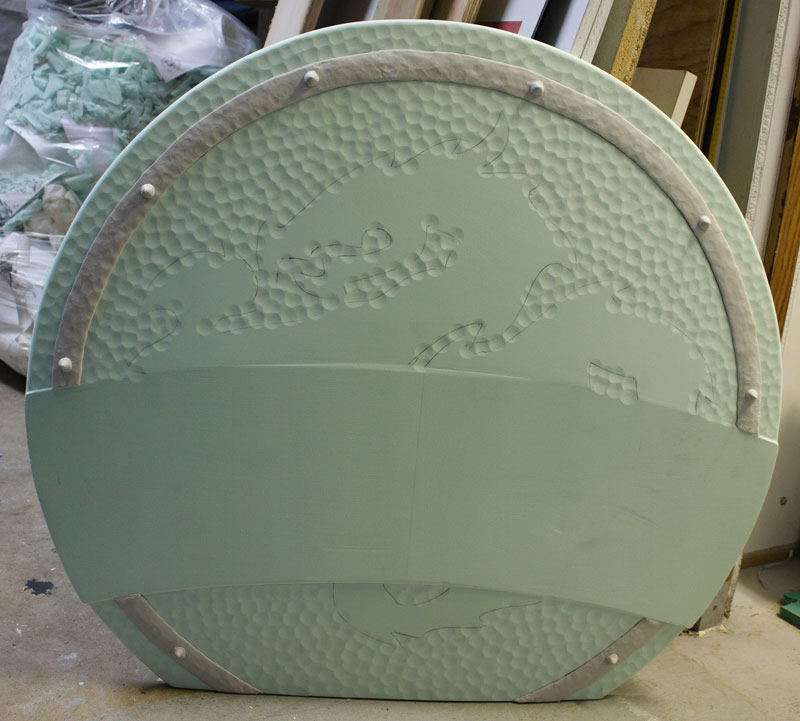

Here's a hammered metal effect done on HDU. I used a hammer to make the effect. :)
Magic Sculpt was used on the "wraught iron".

signsolutions
@SignMeUp,
Love that look! How are you adhering the MagicSculpt to the Foam? I attended the Sawatsky workshop last year, and did a lot of MagicSculpt onto armatures, but not directly to foam.

I just pressed it onto the foam. Sticks like stuff to a blanket.
