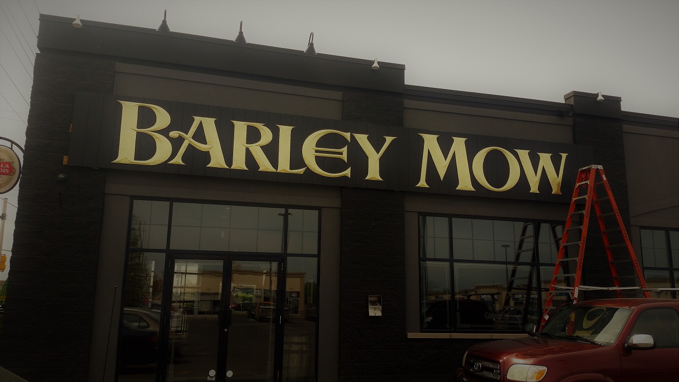

Here is a shot of the nearly completed sign. Thanks again for the advice! --Mal

I'm sure what you got paid for that is well worth the temporary hassle. nice.
neato
Wow, now that's a nice looking sign. Is there a texture to those letters? From the pic, they look hand carved.

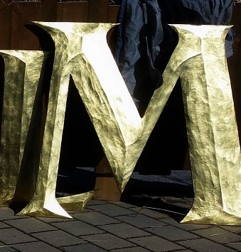

Thanks. Yes, they are jigsawed out and hand carved with large olfa knife and many blades, lol. These are done in 3/4'' Extira. We leave all the toolmarks in.

Beautiful work!!!! Did you say you carved the letters out of 3/4" Extira? If so, just out of curiosity, why not use foam board?
