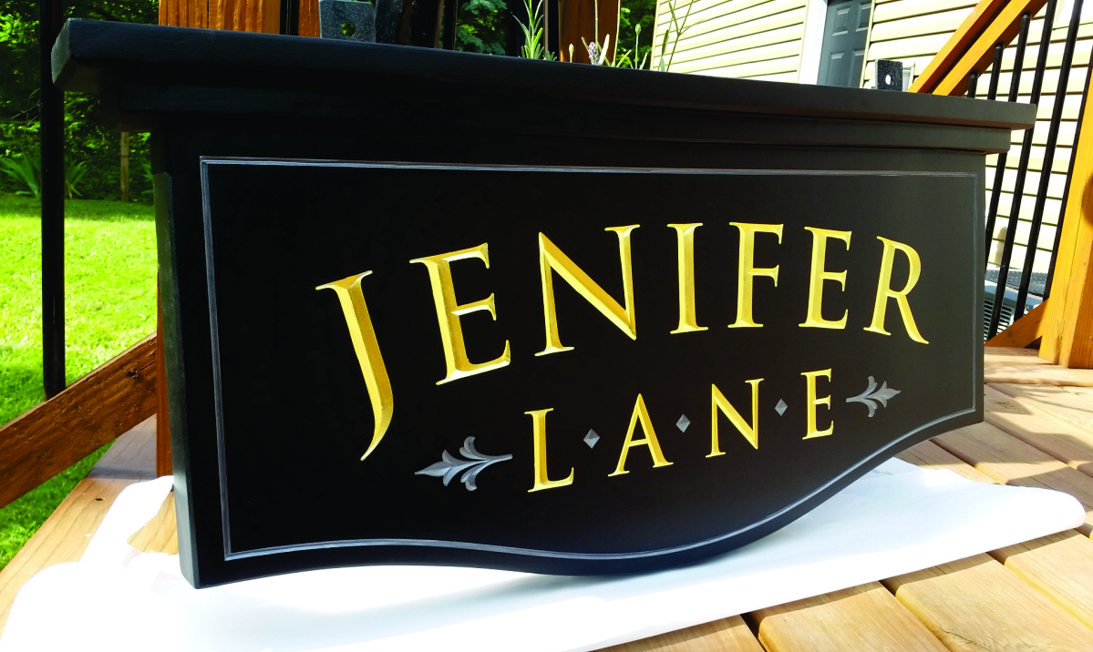

Here's one I finished up a couple months ago. I had some paint issues with this one and was glad to see it get out the door! But overall, I'm happy with the final product.

Very nice. Simple and plain. Great job.
I take it that it was hand carved and not on a machine.​

Hi neato,
nice looking sign. It came out really nice.

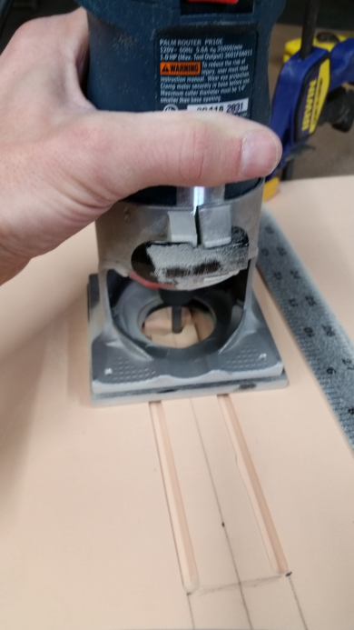

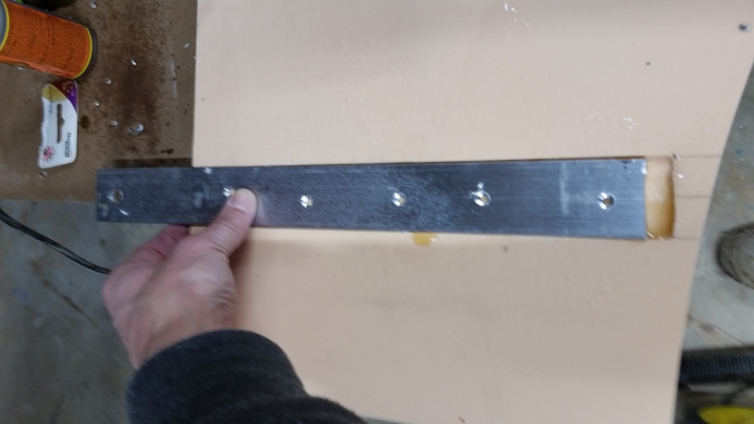

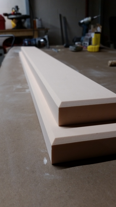

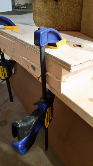

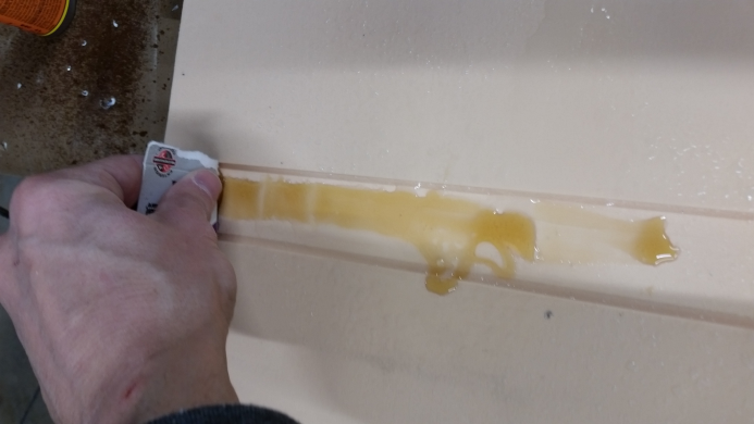

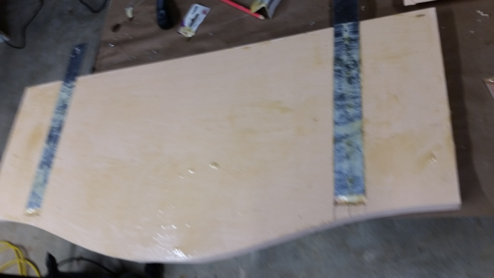

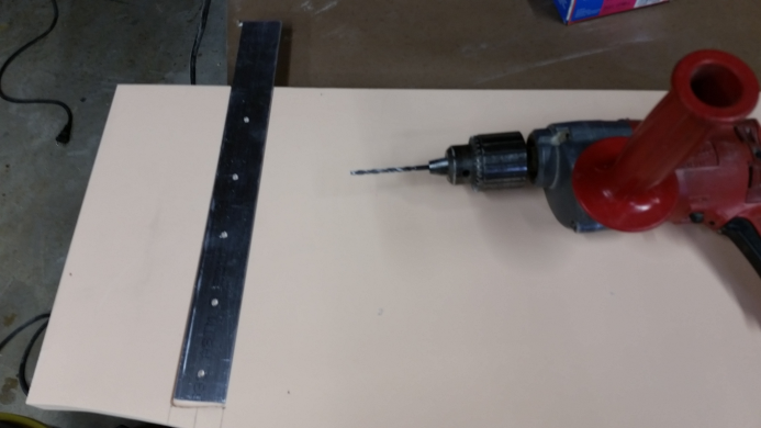

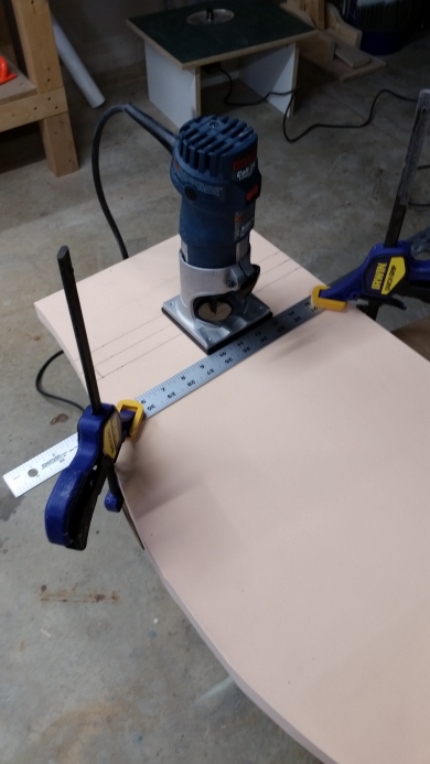

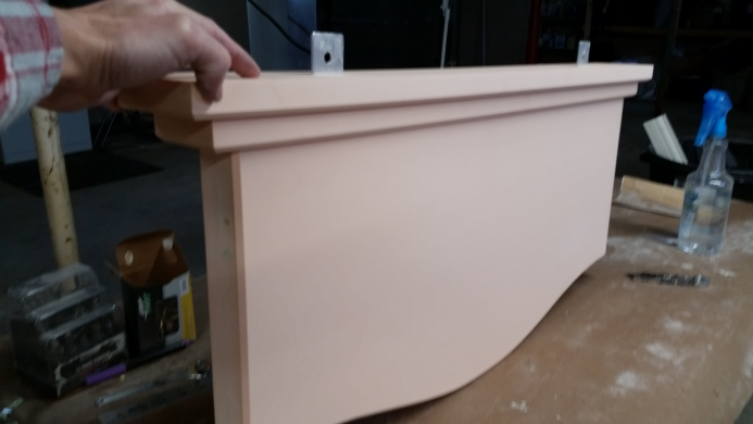

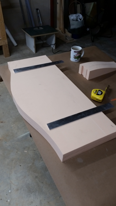

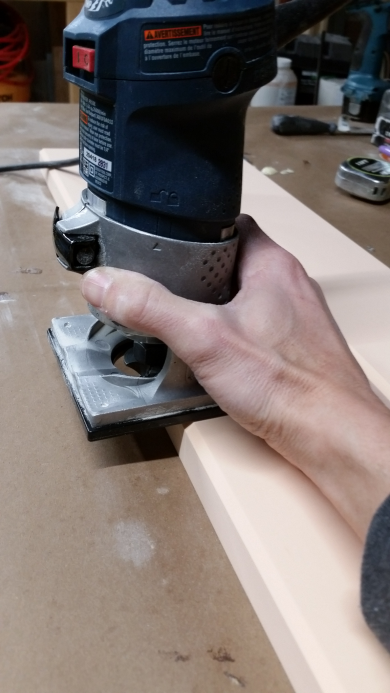

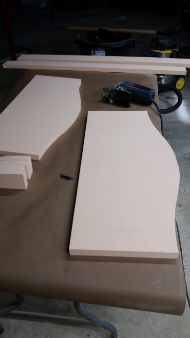

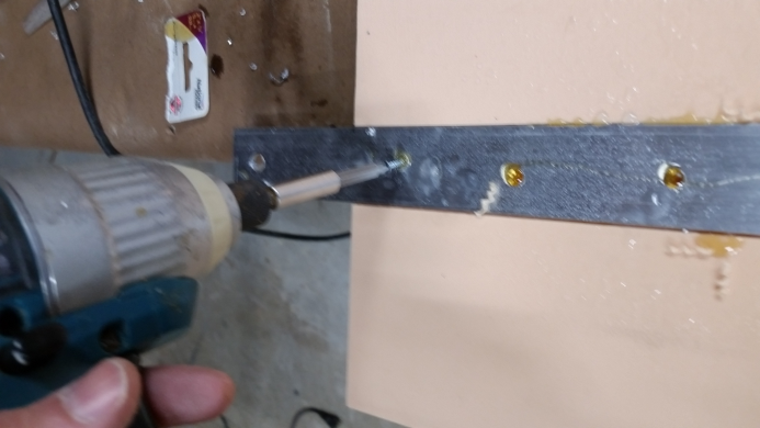

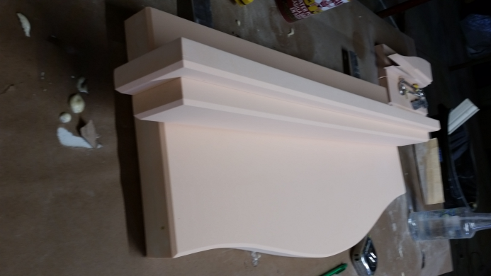

Here's how I did it based on suggestions from another experienced sign maker. I'm sure there are better ways, but I think this should be sturdy enough for the application. The photos should be in order.
I like this one a lot neato, especially the top crown moulding (is that the right term?) detail. I'm assuming the material your using here is signfoam? Can you describe a little bit about your paint issues and how you solved them?

Go for it! It does take a bit of practice, but isn't too bad.
I'm still unsure what happened with the paint, I think it was just a matter of not cleaning the HDU properly before priming. I ended up changing the paint and primer and cleaning the bare HDU VERY well and that solved it.

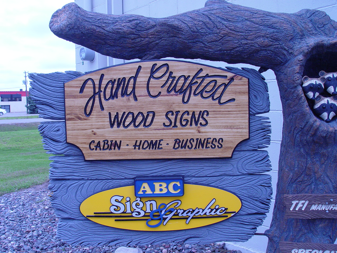

Nice job Neato- we have an old phart [he is actually younger than I am] that carves wood signs with a hand held router. He saw someone doing it at our State fair doing in a booth and has wanted to do it for decades, started practicing and he is pretty good at it for casual signage. He draws out the sign and then just does it. We went to a one day class with Dan Sawatsky a few years ago... and he is an actual artist.
