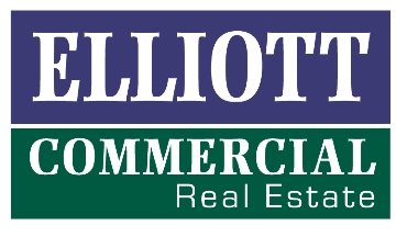

I need advice on handle this situation. I have to print this sign 244x100. Clearly i can't use this file. First of all, If anyone could tell me the name of these fonts, that would be usefull. second of all, this picture is not in the correct proportions, so i'm not sure how to handle that. lastly, does anyone have any good advice about color matching in this situation?

two rectangles and three lines of text... what is it that has you stumped?
font looks like utopia to me

fonts used are Ellington and Eurostile. You will need vector software in order to typeset and rebuild this. You will have to suggest a new layout to make these proportions work, otherwise you will have more blank space on either side

What has me stumped is how recreate it EXACTLY without going around all that fuzzy text with a bezier tool mostly. I could not find a font to match, but i have over 2000 fonts to look at.

Vinylman
Well Newbee:
This is what your asking to have happen IF you follow the instructions you have provided.
I would require you to totally distort the lettering and thereby destroy the customers identity [e.i. logo] if that is what they have been using as their corporate identity.
As to the letter styles??
How long have you been in this business?
Do you have ANY design background/ Skills?
How did you land a sign project of this proportion if you don't know even the basics of sign layout?
Could it be you are out of your element, and asking the people here at Signs 101 to once again cut their own throats, and bleed knowledge and potential profit from someone in your area that has spent many years trying to feed his family by providing this type of PROFESSIONAL sign design, so you can make some "extra income" while you are currently laid off from the local Taco Bell?
Just asking.

What is your time worth? Send it to me and I can have it fully vectored by tomorrow sometime. As for the layout, that is something you need to discuss with your client as to what is acceptable. Distort to fit, or make changes or suggest a proper size. Often customers don't have a clue when it comes to proportions

The fonts were already named for you. Your first step is to acquire the fonts. Next you type them out using the image as a template. Next size and position them to fit the template. Finally convert the text to outlines in your vector program, delete the image template and save the file.
If that's beyond you capability, then have The Vector Doctor recreate it for you. Very reasonable and fast service.
Assigning the colors is done in whatever application you're using. If your client is concerned about color matching then he should supply you with PMS colors to match. Otherwise, you will be left to proof them and submit them to him for approval.
BTW, if you tell the customer that there will be an art prep fee of $250 because he has not supplied you with a vector version of his "logo", you will witness the magical appearance of such a file ready to use with all the colors already assigned.
