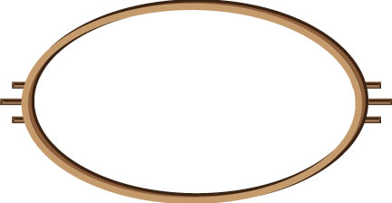

Here's a sample
Here is a three minute sample I threw together in a program called Typestyler.

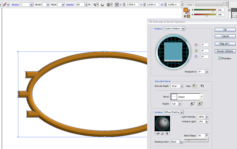

Seems like you could get pretty close using the bevel tool in Illy without plug-ins or too much work.
wayne k
guam usa

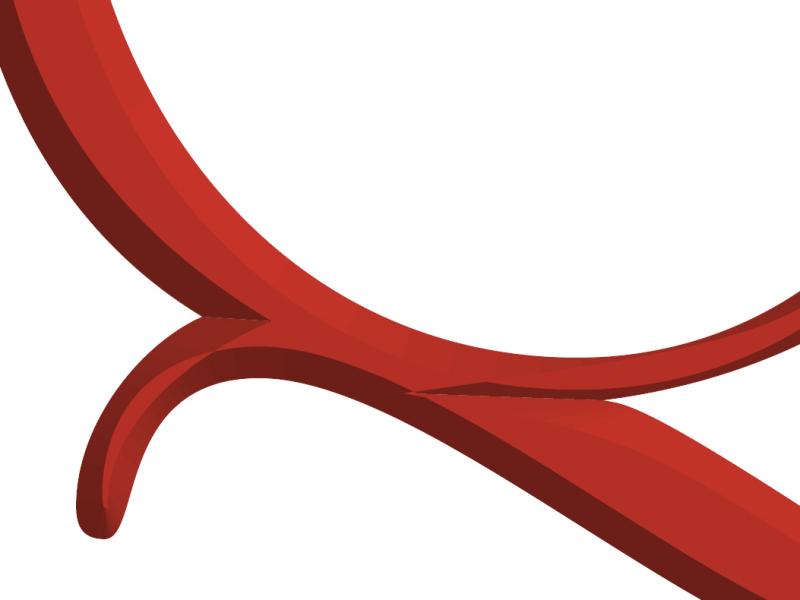

Also the reason AI is not the proper place for these types of bevels is because the tool does not work flawlessly. See the attached image of a letter with the bevel applied. It works ok on simpler shapes but some lettering and sharp corners gets a bit funky
Mosh
All bevel tools get funky on detailed stuff. We do the bevel then node edit it, or in this case just make it.
Reverse weld some ovals pretty simple. I use the bevel in Corel or signlab myself.
