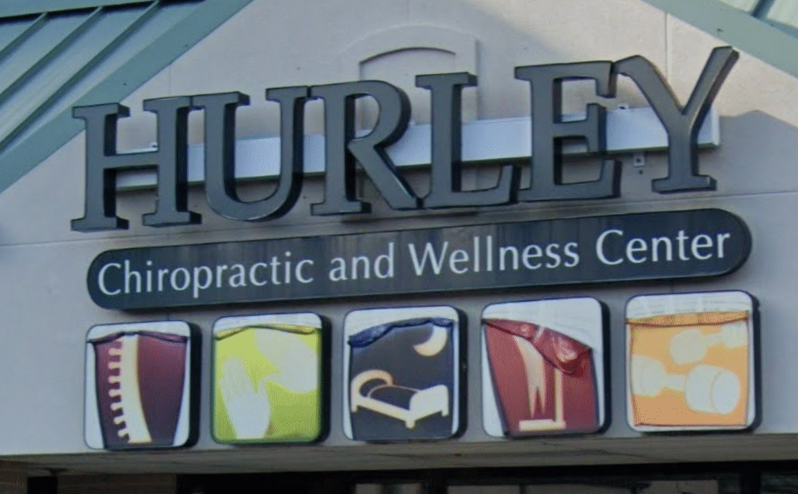

This sign just turned 10, cast 3m perf and black vinyl, still looks fine. The calendared print material gave up after about 5 years.

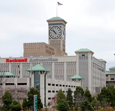

this sign turns twenty next summer!
3M cast trans vinyl still holding up but the polycarb is a bit yellow'd and the LEDs are noticeably dimmed.
used to be the largest four-faced clocktower in the world, until the Saudi's out-did us in 2010.
