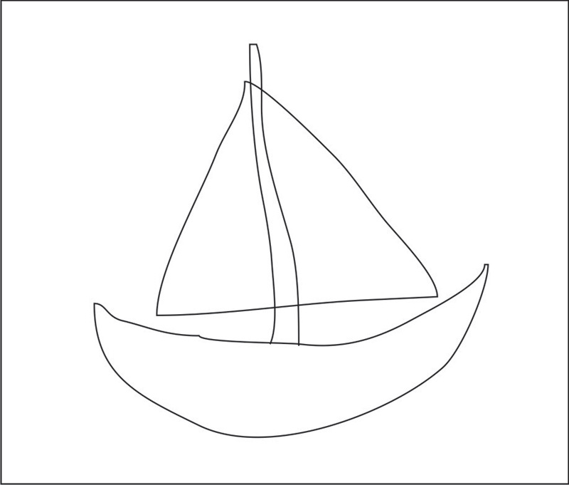

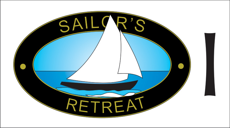

Here is a layout for a carved sign for a cottage. The sign is a gift for a boyfriend of the client. The boyfriend has a "40 foot sailboat". Is my crude depiction close enough to a sailboat? I mean are the sails totally wrong? The client doesn't know any more than I do and I can't ask the boyfriend.
Also I need a font that the sides curve in like the rectangle beside the picture but real simple like Arial.

Optima or Letterheads font, Stevens Percepta. Sailboat is okay Adrian but maybe add a mast in there somewhere..
signmeup
Thanks Bob. I looked on google at sailboat pictures till my eyes glazed over. Decided to just wing it with something I could carve easy. I'm going to do the water with some Magic Sculpt I think. I want it to spill over the outline of the oval in the front a bit. Should look cool.

I think you're covering up too much of the 'O'. I know you can read it, but it still bugs me.
eye4clr
+1 on the "o" cover.
The sails are generally correct but the front sail (jib) is usually a bit bigger than you have it and the aft sail (main) is a bit more narrow and it's base further back for most mainstream boats today.
Also, the bottom front corner of the jib should look attached to the front point of the boat.
A simple way to make it look like there's more motion is to have the trailing, curved edges of the sails be scooped concave and have both trailing edges parallel. Most of the time when a sailor looks at sails they want to see symmetry.

The leading and bottom edges of the mainsail are attached to rigid members (mast and boom) and therefore should be straight.
Also the leading edge of the jib is hanked (or attached otherwise) to the forestay, which is also straight and which is attached either to the bow or to a sprit extending forward from the bow.
I'm a sailor and when I first looked at your depiction, the klaxons went off -- "WROOOOONG, WROOOOONG, WROOOOONG..."
A sailor will always notice the sails and how they're set. Fix those couple things and you'll be fine...

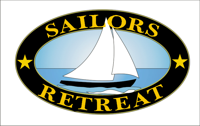

Here's the final with Optima. I left the sails with curved lines because it's prettier. I'll dick around with the kerning a bit but I'm happy with it. Thanks for the input.

still thinking too much of the letter is covered by the sail. maybe move the boat down some. please post the pix of this once you are done as I love to see your work.
Ummmmm, yeah. You might think its prettier and you might be happy with it.
But I guarantee you every sailor worth his/her salt who sees this will ridicule the curved leading edges of the jib and main.
Sailors are funny/weird about that.
Fair warning.

Oh, and another thing... the foot of the main is always higher than the foot of the jib -- the opposite to what you have.

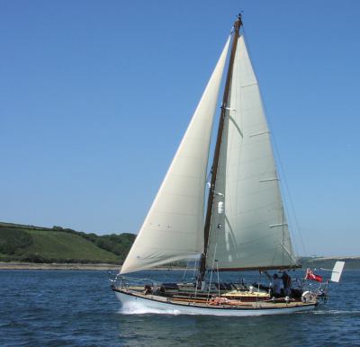

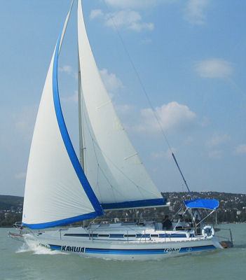

Here. Note the curved jib. I'll give you the main but I have no trouble finding curved jibs. This is for a cottage so I think it will be fine. Thanks for your help though.
The leading edge of that jib is not curved but rather hidden by the curved sailshape in that photo. If the forestay was really curved that much, that boat's rigging would be in serious trouble...
