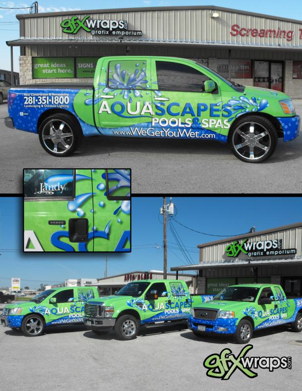

Now you're talking my language. I love lime green, chartreuse, grabber green... anything in that family. It really stands out in a crowd. All I can say is take your time, print small color tests -- and print several at once to save time, keep track of the tweaking you do and when you find a color that you like, write down all your settings somewhere!
Some hints and tips if you're using Versaworks with your Roland...
We've had much better luck geting the colors we want when we design in AI or PS in RGB color mode. We don't print much of anything straight from Corel... the color management sucks. But we still have x3. I cannot attest to the newer versions.
If we have to do significant tweaking to achieve a certain color for a customer, we typically save a README file in their client folder with all the color values and settings.
Here's a couple of different bright green products we've printed on the VP540. The trucks are printed on 3M 180c v3. The storefront windows are printed on ij35. And for comparison's sake, the GFX in the channel letters is 3M lime green calendared vinyl. The prints will never look as rich as the colored vinyl, but our prints are still quite vivid.
Good luck!
