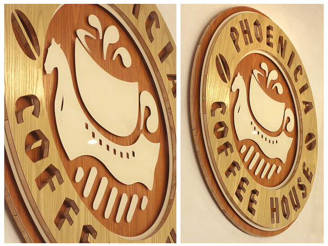

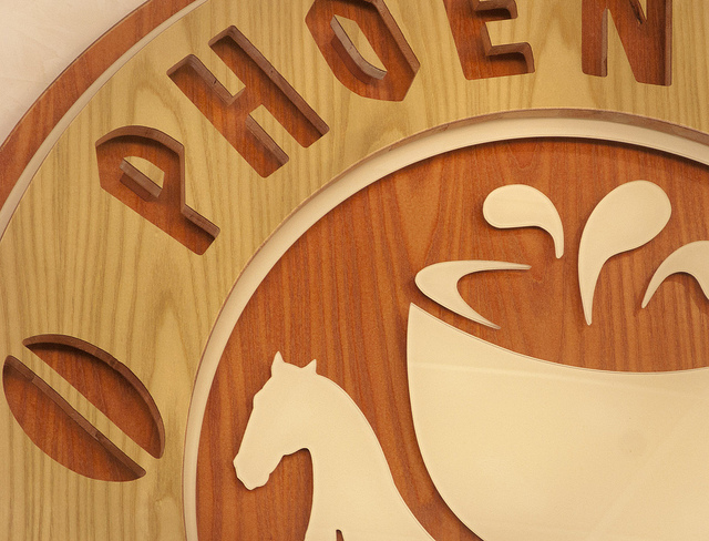

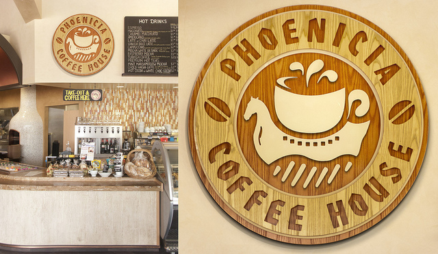

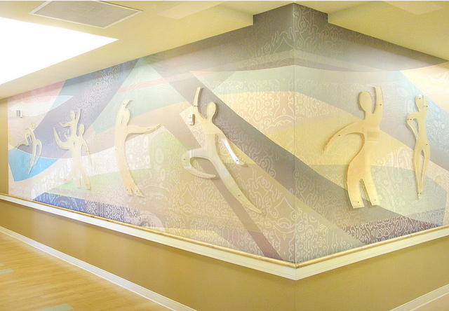

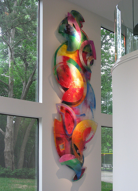

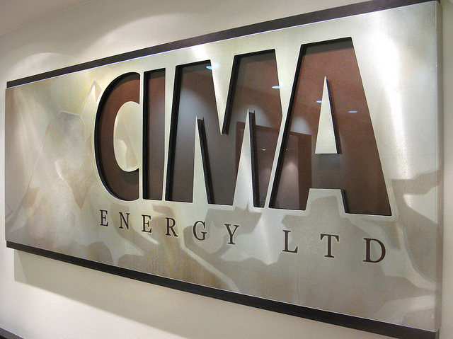

i made this sign with my piece of junk. probably not worth more than $1500 used. a $20,000 cnc would have produced the same job. only i would have been forced to charge the client a lot more because of the overhead. in the end delivering them less sign for the money. or the same sign for more money.
