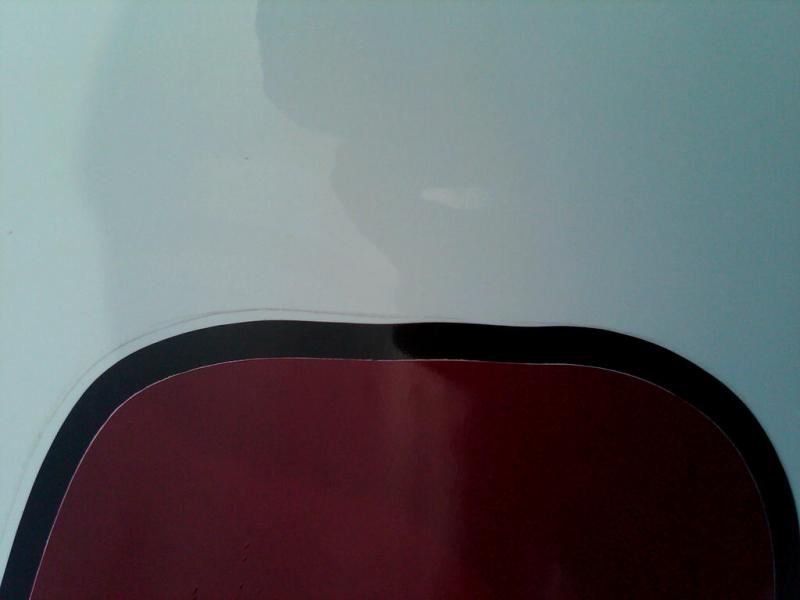

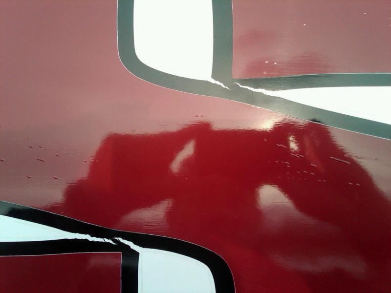

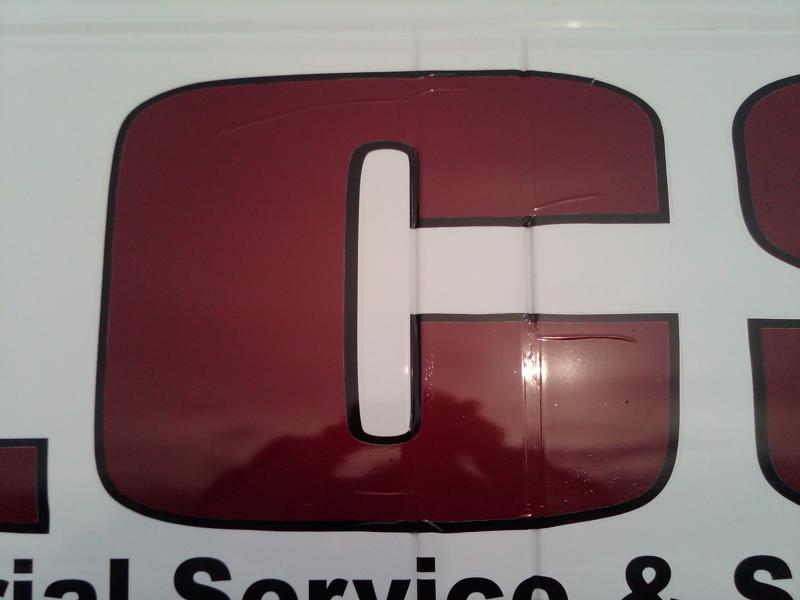

Ok so I get a call this morning from a company that i did work for about 15 months ago. I lettered up 11 vehicles for them as they changed there logo. So the customer tells me that the letters are screwed up on one of the trucks. I told him I would stop down after lunch only to find this. (See pics attached) I then proceed to check some of the other trucks I did and noticed that the others are starting to do the same thing:frustrated:.
I am not going to put the brand of vinyl I am using at this time as I have not talked to the company yet. What I was wondering is if anyone else has seen anything like this and if so what was the outcome. What did the company that produces the vinyl do for you if anything? My day went from a very good day to a very bad day as it is looking like all these trucks alon with 2 4x8 signs will have to be replaced. :banghead:
Oh and by the way no those wrinkles were not there after the install. LOL

Is it high performance. Looks like what would happen if oracal 610 was used on vehicles. The old place it is coming off is around the indent in the van?

Had this problem once with an etched vinyl about 6 months ago. I had never seen it happen before and the only thing I could think of was that the vinyl had been sitting in the office for at least a year and a half and might have just gone bad. I bought some new 3M dusted vinyl and re-did the job with no problems. It looks like the same thing though... massive shrinkage causing cracking and wrinkling. If you were using new 5-9 year vinyl it shouldn't have happened. Your supplier might have had it sitting on the rack for a while too.

Ok I just added another picture of the same van that shows the shrinkage of the material.

BillCt2 It is layered vinyl
Poconopete: I will have to check with them as I know they have a pressure washer in the garage. The white you see around the two layers is actually wax.

It looks almost like you applied cast vinyl over calendared vinyl. From the pictures it looks as if the black layer is experiencing shrinkage and the top layer is not. That might explain the wrinkles and the "bunching".
What was the preparation method you used before applying the vinyl? It would also be helpful to know more details about the specific materials and the application methods, even if you don't want to name the brand you could still describe the specifications of each material.
