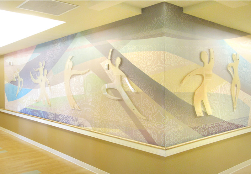

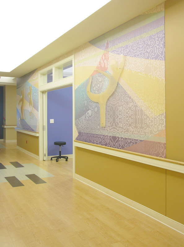

finally got my first wall wrap finished. i have a new resect for you guys doing 50' of graphics. the 2500 pixel photoshop brush looks like the end of a cutip on a piece like this.
next time i get something like this (and i already have two lined up) it's going to require a new dream workstation.
also, thanks to all the signs101'ers that helped me with which material to use, how to tile and bleed it, etc.

looks great bro! been dying to see you post about how it all went!
what texture Korographics did you end up going with? i've always been an UltraFlex Wallscapes guy, but I might try my next project with Koro... they've got a HUGE selection of textures.
artbot

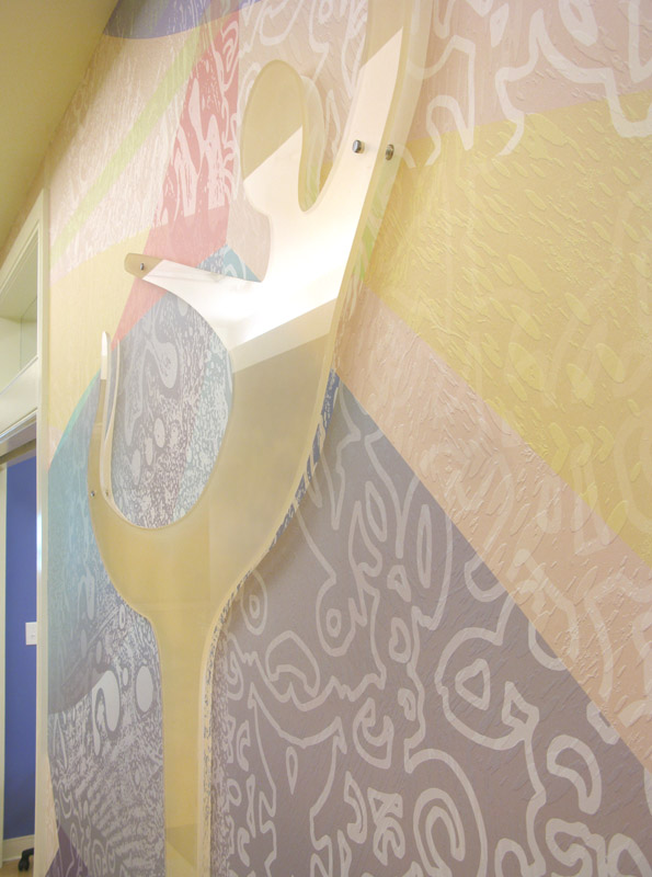

thanks,,, the material was korographics abaco beach. the installer mentioned that is the industry standard. that she runs into it more often than any other media/finishes. after seeing the tiny grain finish, i was glad that i didn't go with some more "creative" texture. there are so many things to focus on in a complex architectural space, keeping it simple is usually best. also, i printed in a fluid wall texture under the graphics of the piece. it provided a faux wall texture that i could erase or stengthen depending on where i was in the image.
the standoffs, i make my self. they are brushed steel dipped in CAB gloss lacquer. i've never used factory stand offs. they are just too huge and expensive. this project has 50 stand off's cost ($12).
the installer for the wrap was cyndi greene. i very highly recommend her, she could not have been more professional or more of a perfectionist.

hey art,
Great job. I think it would have been awesome to use clear acrylic? What led you to use the white?
artbot
it's not white clear acrylic. it's a custom finish that i sprayed on the back (misted opalescent white, then misted translucent latex matching the pre-existing wall color, then one more mist of opalescenct white, then clear coat).
the graphic has the same figures printed behind in a bit of white/saturated version of the graphic. when veiwed as you wall by the two images move and shadow each other.

ahhhh.
i see. that's awesome man. Great job.
