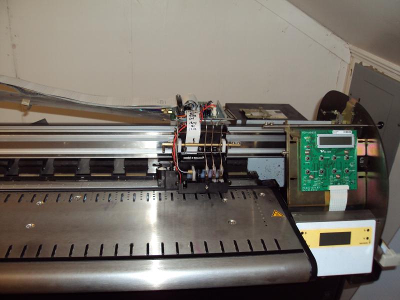

update...I have the machine apart and was able to draw the Magenta up to the damper. It is at the damper but not in as the tube would not fit in the bottom of the damper. So, at this point do I need to put everything back together before I fire it up?
Cleaning cycles first?

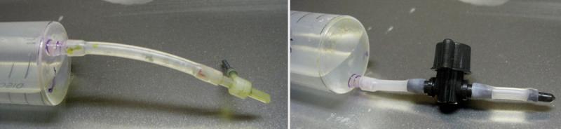

do you mean the tube that you used to draw ink at the pump doesn't fit the damper? you'll have to take the tube off and press the head of the syringe firmly up against the damper end, leaning it back so the ink fills the top of the damper, thus drawing air out first.
if you have an old head take apart the head adapter and stick it on the end of the rubber tube and use it as a plug to seal the interior of the damper end.
pic attached:

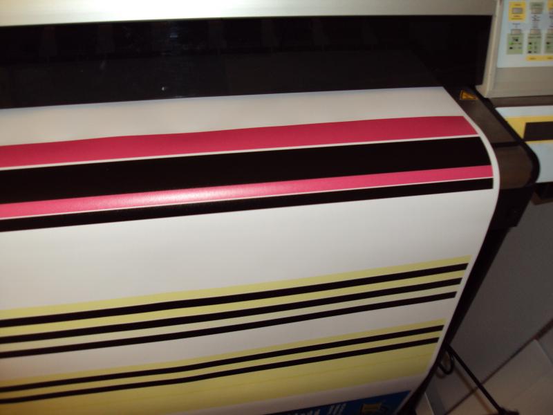

update...(crossing fingers, knocking on wood and thinking I must be living right) MAGENTA!!!
After drawing the ink to the damper, I parked the head(tightly held in place) then draw from the waste line. Ran a strong cleaning cycle and did a test print...MAGENTA!
Now, before I get to excited. I did not replace anything, no leaks to be found. Might I have an air leak some where or something starting to go bad? Did I actually run out or Magenta in the cartridge and the machine did not tell me(some type of sensor not working?)
Well, I am going to run some prints and see what happens. I will update in a week or so if things are still running smoothly. Sooner if not.
Thanks to all!!!

gbarker
Thanks to all!!!
IF you didn't find a leak my guess is the cart ran out the the sensor didn't register the empty cartridge. I had that happen to me once or twice.
Glad everything seems to be up and running.
