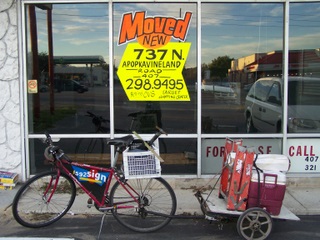

Some of you maybe wondering what my main work is and how I do this riding the bicycle pictured with trailer.
since this has been my MAIN transportation this year so far 7 months 3 mths with my pickup

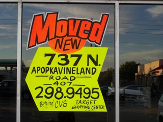

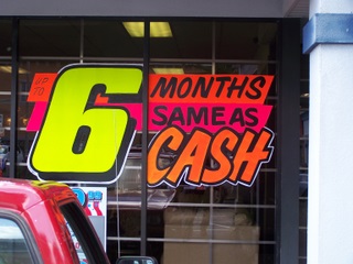

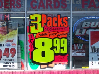

each took about 1 1/2 hrs (had to wait for paint to dry) before I can letter and outline
1st cut & squeege on wet ..white vinyl paint mask
2nd lay out using china marker or charcoal stick.. when avaliable.. then color
3rd lay copy on darker panel colors then letter & outline
4th cut away unwanted white vinyl ..clean up ..done

thank you ya'll for your words are kind .. it does get to me but at 58 no complaints to be still riding and good health.. and getting more used to using this computer lol to place pictures etc
.... yes do get strange looks with all my stuff carryed, since my trucks have been down so much building a trailer that will hold at least 500 lbs. and my scaffoldling some jobs will use 3 sections up plus wheels n legs and all needed ..trying to cut down on trips
... sometimes a little hard to present a good image selling .. then again others have been sold cause I'll take these steps to work done
the cooler is great for keeping paint and supplies ..less chance of paint drying out during transport even in my truck or my box van which also not working
biggest hassle here is the county n city does not bicycles on the roads, even police hassle me n threaten besides people on a daily basis, defence has come to mind a few times

Cool stuff. May sound corny, but I love the C in CASH in the first pic. Just a really awesome C. The rest is great too, but I love the C.
I'm such a dork for hand lettering....

Am I to understand that you're painting these on TOP of a low tack vinyl??
I've done ALOT of window splashes, and never heard of this trick.
