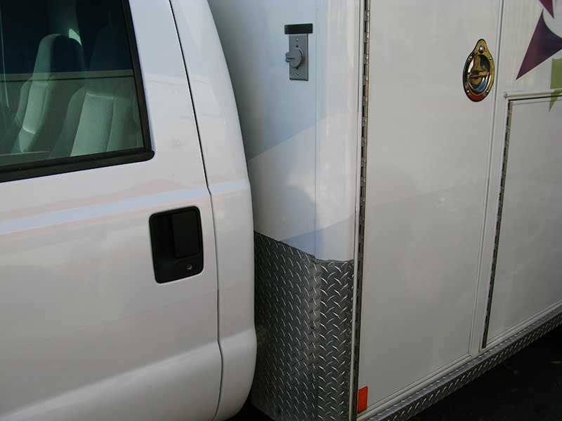

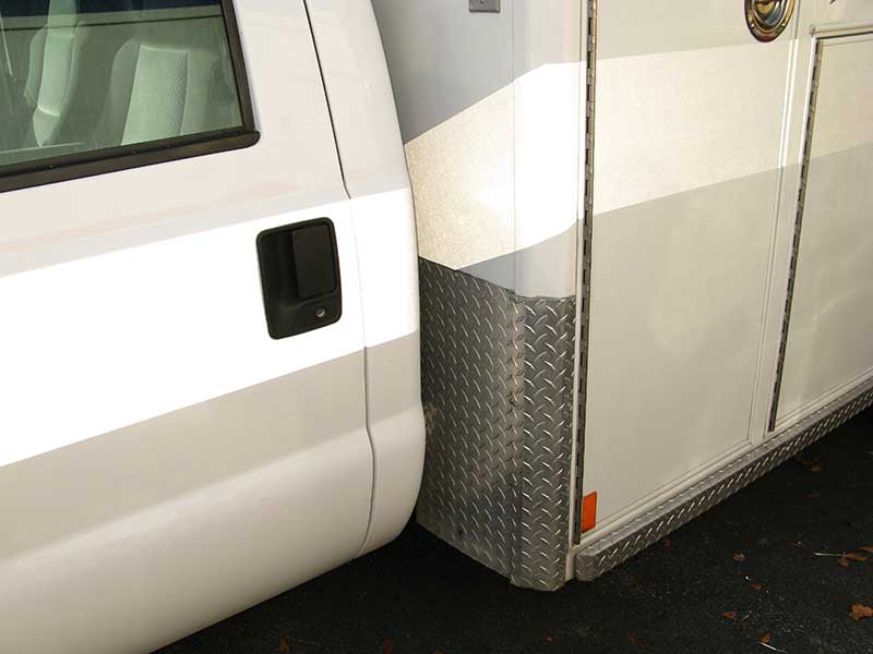

SightLine
Unprinted reflective on a white ambulance with and without a flash.... At many angles you cannot see the stripe at all but's not perfect since bare reflective is not exactly white. We have done black on black as well which does dissappear even better. :thumb:
