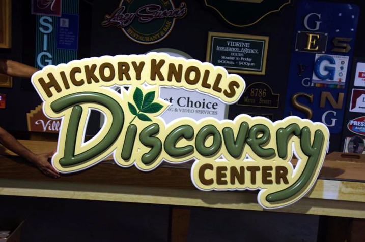

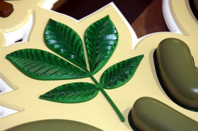

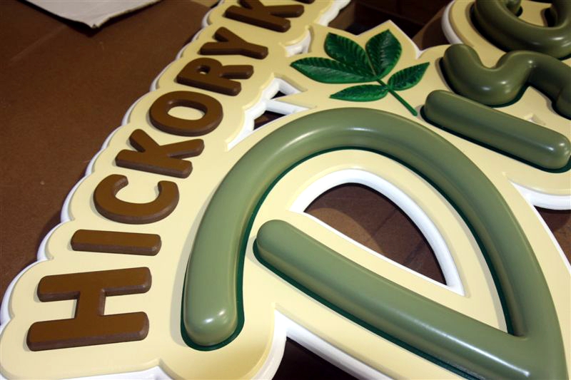

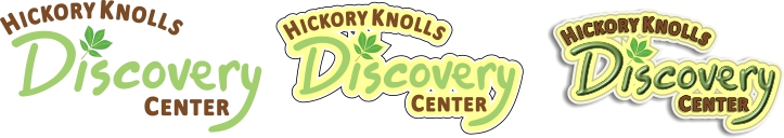

I was sent a not very good logo and was asked to make it into a carved sign. Well it was a little tricky to work with but I ended up pretty pleased with the outcome. The first pic shows just the letters they sent me. The second is what I came up with to hold everything together. The other pictures show the end result with a few close ups.
I personally would not have used the design sent, I'm sure I could have come up with something better, but that wasn't an option.
This piece is being stud mounted on a wall just as you enter the center. It's made entirely from PVC except the rounded discovery letters. I made those from HDU. All paints are latex. The overall size is 32"h. x 72"w.

Wonderful. That is truly wonderful.
Are they all different layers as in separate and then glued together ??

Thanks for the close ups. They really show the construction.
