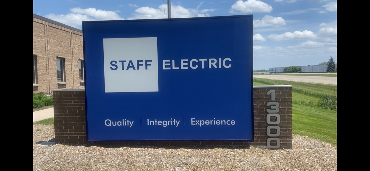

We have a project that requires (2) translucent faces on an LED light box. The dimensions are 64" x 67". We print using a 60" HP latex printer. We printed on translucent vinyl and adhered it to the lexan panels. Because we had to seem it, the seem has opened up in about 6 weeks. How can I provide the appropriate print with these dimensions without a seem?

I see you added a pic. That's a tough one but my gut would be to overlap right in the middle of the sign. It's not uncommon at all to have a small overlap in large signs... it just sucks yours is close to the ground. When I have to overlap, I call it out in my artwork so everyone knows before hand what to expect.

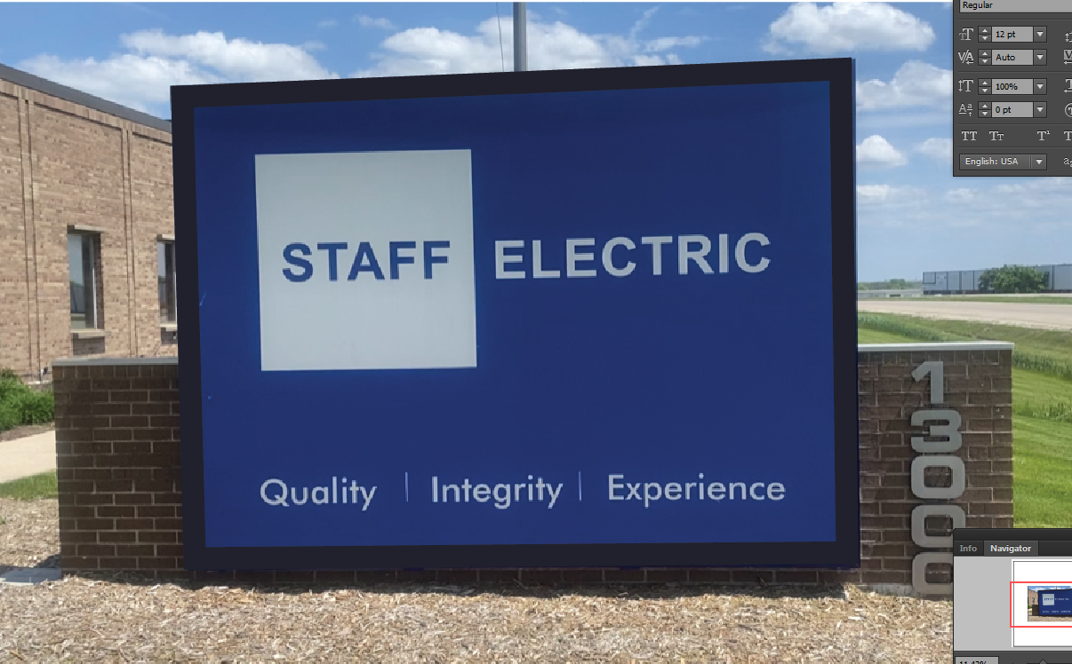

I agree with the comment above to put a black border around the edges. Or, just do this one in paint instead of a print.
............. I POSTED ??
Why the f*ck did you post a picture that has nothing to do with your predicament ??
Ya know folks, there's another thread taking place about proper grammar, punctuation and whatnot...... and this is a good example of why people cant' do jack. If ya can't communicate, then how do you expect to be f*ckin' helped ??
