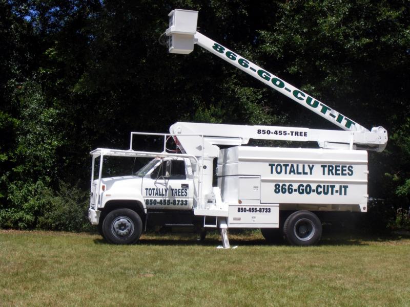

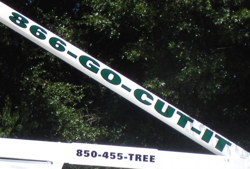

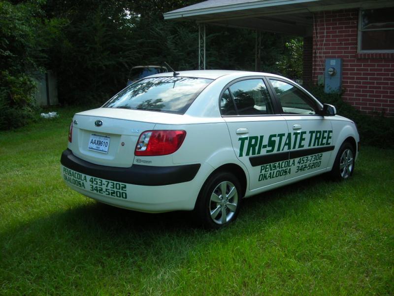

sorry to inform you david........BUT what i said is FACT!!!! HP vinyl is great for NEW EQUIPMENT/TRUCKS/VEHICLES that dont take any USE/ABUSE/ROUGH WORKING CONDITIONS like ROOFING, TREE SERVICE, LAWN MAINTENANCE..........and i know this from EXPERIENCE.....i have vehicles out there lettered with HP.........And i got em lettered with calendered. and i know enough to put the proper vinyl on either vehicle.
back when i 1st started to do vinyl, i had a roofing company that i did all hand lettering for. i did one truck with HP VINYL........LASTED 6 MONTHS!!!!! trucks that are not driven or taken care of by THE OWNER..and are driven by workers....... these drivers dont take any precautions to not scrape the vinyl. i re did that truck with calendered vinyl, and NEVER REDID IT AGAIN... it went to the scrapyard before the calendered vinyl got destroyed. just did this bucket truck last fall. reflective and calendered black. other vehicles done in calendered....and they will probable drive them for the next 5 years........without any replacement of the vinyl)))))))))))))))))))

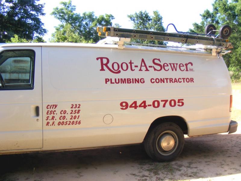

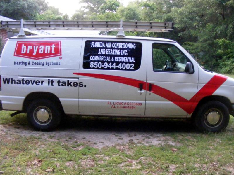

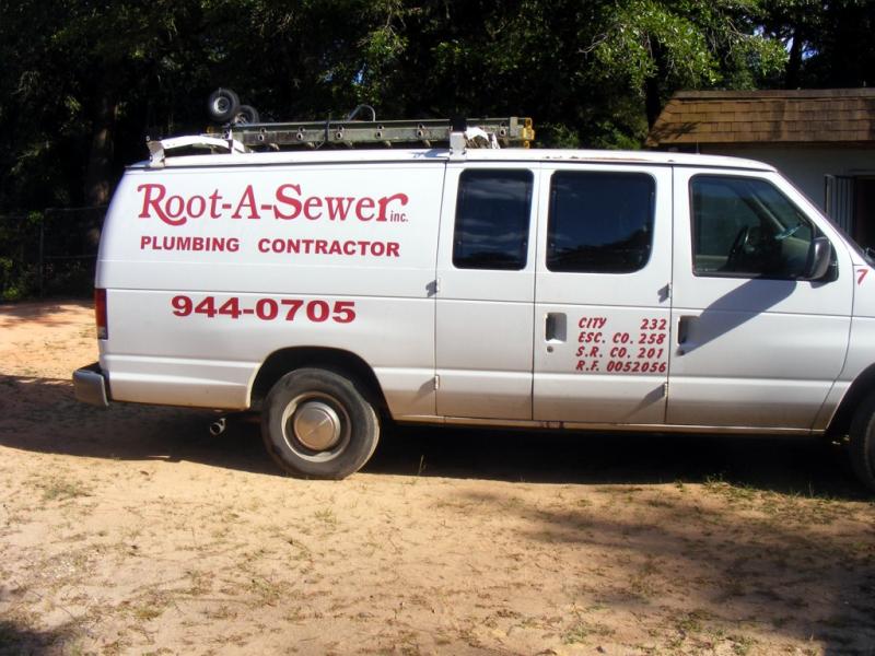

well you was sold that story....and bought it.............i know better.....been puttin SHINE RITE on vehicles since it came out........and to date i have had NOT 1 REPLACEMENT OF IT.....even the reds..........and if your old enough to remember SPAR-CAL............... you know how their red faded.and i have vehciles out there with HP.......in fact i tell people the best red vinyl you can buy is AVERY HP, if you have a color chart, find the red that has a silver backing...........this stuff is the longest lasting red i have ever seen. i did these 2000 ford vans in 2000............and these pictures are from 2013................zero fade...

didn't Spar-Cal get bought out by Avery or some other brand of vinyl? I remember it being crap like Avery so not too surprised it faded. as long as you are happy OP and your customer aren't willing to pay for the good stuff, good enough I guess. to me cheap vinyl is what gives vinyl sign a bad name as people have seen the peeling, nasty looking stuff falling off signs/trucks and whatever and assume all vinyl is crap
