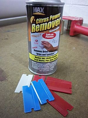

We've tried them all and this is the best stuff we have ever found for removing adhesive.
Plastic razor blades are mighty handy as well.
