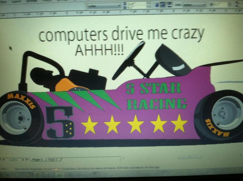

Ok guys, I have decided that I want do try to get into wraps/graphics kits. I want to start small with go-karts. The reason for go-karts is because of the demand in my area and the simplicity of the go kart templates. There are 2 dirt tracks within 30 minutes of my house and people have been asking me when I am going to start doing stuff for go karts, they say that it is hard to get him to do anything, so I am willing to step-up to the plate and help these folks out. I want to make sure I have everything I need before I even start, so please chime in and let me know:thumb:. The big thing is learning how to incorporate designs into the template. I have practiced on one template, I will post it but please dont make fun of it.lol At least I tried.
Materials/Equipment: Summa DC4sx, Corel draw x3, Summa color control, lint free paper towels, isopropal alcohal, squeegee with felt and sleeves.
material? 3m 1080?:help
and here is the ROUGH draft....:design:

I did a go-kart wrap identical to the body you're showing in your pic about 3 years ago. I tried to lay it out as a 1 piece deal and due to the complex curves it was nearly impossible to get everything to line up the way I wanted to. Finally gave in and designed the wrap in 3 pieces, LS, RS and Nose. After it was all said and done I charged $350.00 (not nearly enough IMHO) and the customer about had a fit at that price. They came back about a month later and wanted to know how much it would cost to replace 1 side that got scraped up from hitting the wall and I told them $200 to remove the portion of the old wrap and print and install the new section. They never came back, lol.
If you have the customer base and can charge a fair rate for the product you can probably make it fly. It sounds like you already have the equipment and software. As such, you are probably already aware of the higher costs to operate the Summa vs. an inkjet? If you've never wrapped before, I strongly urge you to start practicing. Those go-kart bodies have a LOT of complex curves - especially around the nose.
Material wise I would go IJ-180 or IJ-380 with 8518/8519 laminate. I would also consider the Avery EZ RS material as it can be more forgiving to work with than the 3M.

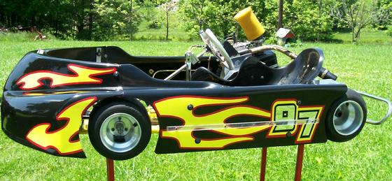

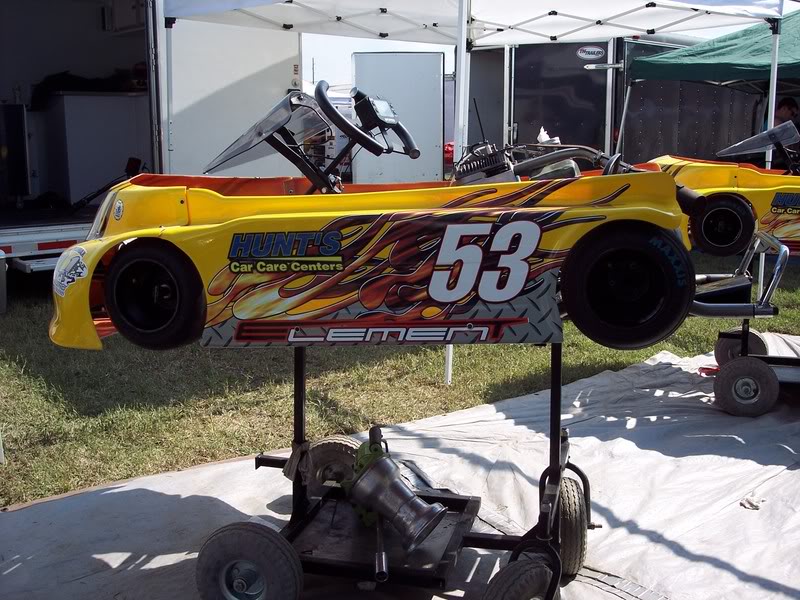

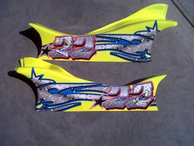

Here are some samples of some really good wraps I found. I mean how do these guys come up with this stuff? I really want to learn!
