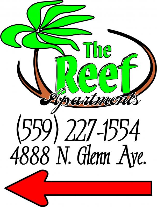

Here is a design I came up with for a apartment complex.
**Does it look too busy?

the address looks squished
the word "apartments' is unreadable
-because of the scripty font
-because it is ontop that curve
Tree looks like pot blowing in the wind, maybe rename the place "Reefer Apartments"
Even so, if the customer likes it then get your money and move one! I'd use 1/2 MDO, or 10mm coro.

well, you really ought to lose the script for the word "apartments" or at the minimum, kern them together at the 'a/r', the 't/m', the 'e/n' & the 't/s'. Make it bold...Apartments is a crucial bit of info. I also agree the palm tree is too stylized. Use a basic bold font for the ph # and address as well. Sell the customer a plastic sign-a-cade for an a-frame that they can bring in at night. Try Denco sales in Fresno.

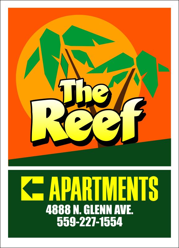

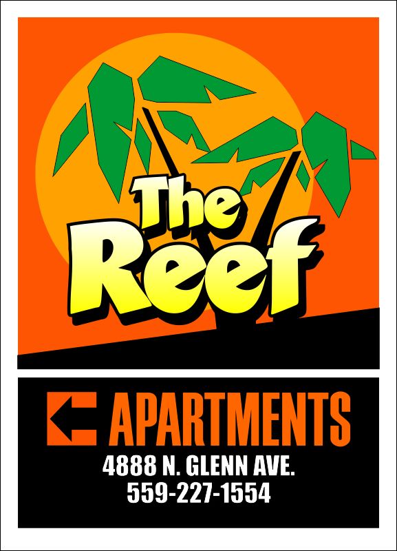

Here's how I would approach it.

Beautiful work, as always, Maniac... Now I wonder if GN understands why it works better than the original.

It's not so much about function. The real issue is legibility. If you can't read a sign because of poor fonts selection, then it can't serve any function. Font's are used intentionally to convey many things. Typography is an art unto itself. You have to really consider how and why you use them.
